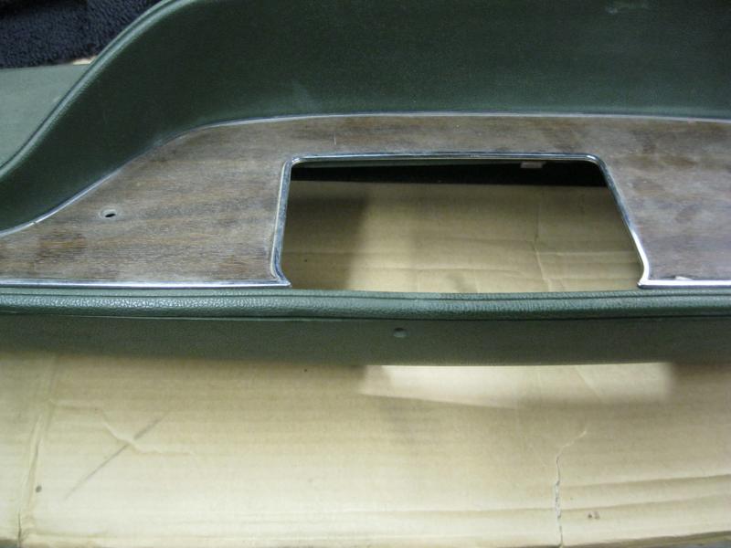

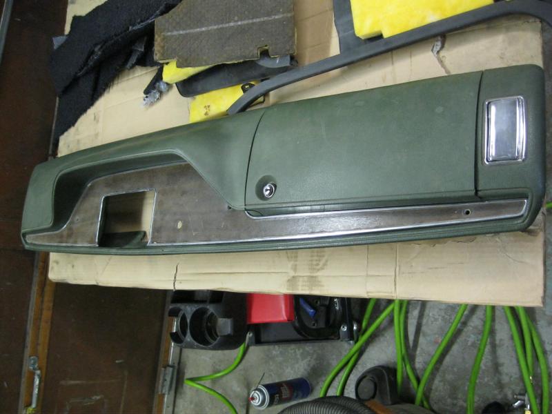

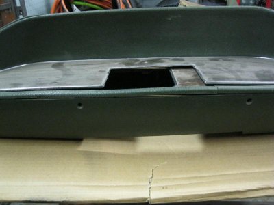

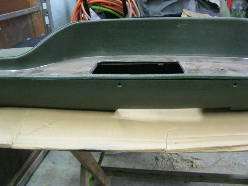

Thank you again for your help and advice getting my Satellite back on the road this summer!
I plan on installing a center console for 71 Plymouth satellite bucket seat car, I have the tunnel hump installed and shifter coming through the floor. I found a center console years ago and it appears to possibly be for an auto car? I have a top plate for an auto and 4speed, but it appears the shift boot just doesn't fit just right with the drivers lower side cutout is. Are there a difference and does anyone have an dimensions on the 4speed cutout and photos? I plan on just trimming it with a die grinder since I can't afford another console or a new one.. I don't think you can really see it that much at all either once installed.. Thoughts and help?? Thank you!
-Jimbo

The lower housing is different between the two. Your is an auto. Jeff at 521 restorations has the template to cut out an auto for a 4-speed.
Thats awesome! Thank you Mark! I ordered the template today and will be adding that to the project list! Very helpful info!
-Jimbo
