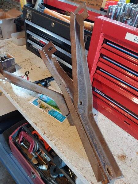

Looking for advice on installing the front bumper after new body and paint work. These bumpers have a lot of brackets and attachment points and if assembled to the frame brackets become heavy and awkward.
This might help.
