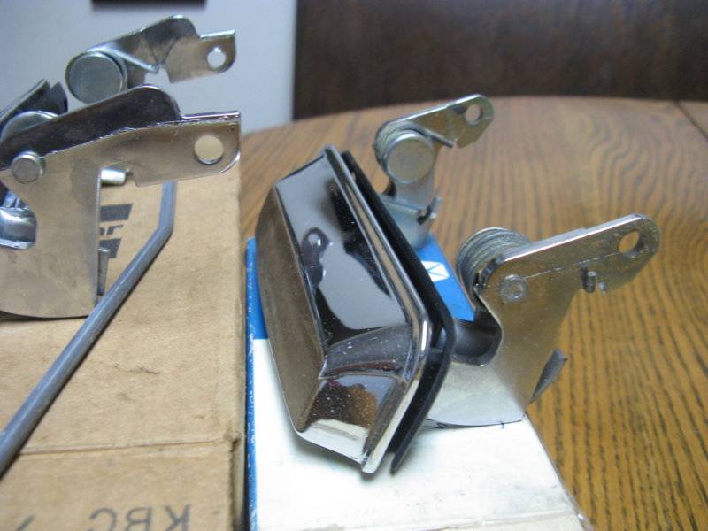

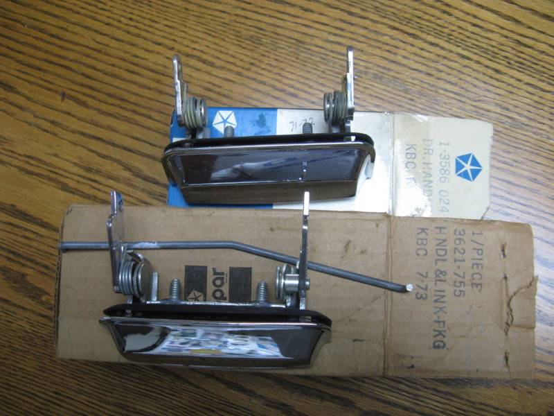

71-2 are thier own 73-4 are thier own they have longer castings where the rod connects... Here are Nos ones compared to each other..
