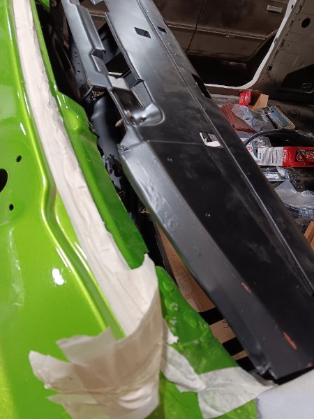

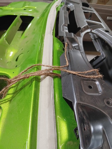

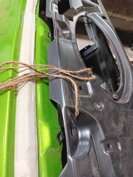

Well, this is becoming common, asking for assistance... what is the issue with the dash frame installation? Picture 1 shows the windshield frame and dash frame. Picture 2 and 3 show when the dash frame is rotated forward, the "bent" downward flaps cut into the paint in all five locations, and no way do the mounting holes line up. I've already gouged the paint several times installing this easy item.

Remove the lower side pivots (the bolts) lift the dash frame slightly and push forward on to the cowl lip, the bottom of the dash will then rotate down and you can put in the side bolts.
Bottom line is that if the frame is pivoting on the lower side bolts it will not rotate into the upper position, it has to go the other way, at least this was my experience with my 71 Charger.
I had my dash frame out 3 times on my 72 Satellite, and never experienced any alignment issues. It's definitely designed to be installed without removing the "pivot" bolts. Have you tried moving it left to right while it's swung up into place? If there is no way to get the holes lined up, I'd say it is possible the cowl area was re-worked. Just my 2 cents.

Well, I discovered the firewall/cowl assembly was replaced with a repop piece. It's a horrible fit, holes aren't drilled, recesses are different than original AND the windshield lips are not even close - so nothing lines up.

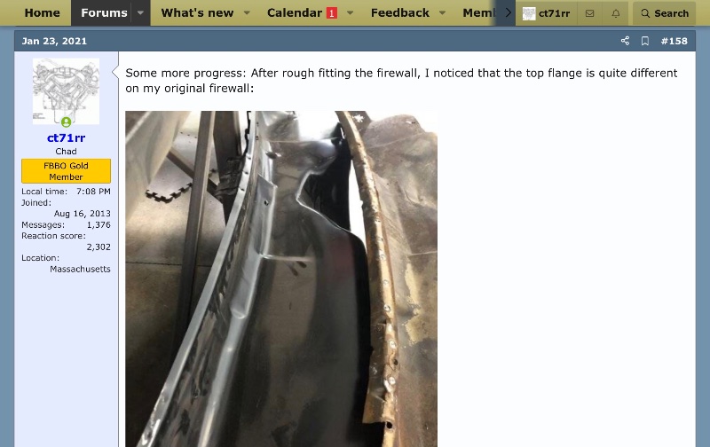

I used an AMD firewall for my ‘71 RR. I had to cut off the entire top lip (it’s correct for E Bodies) and replace with the lip from my original firewall. I wonder if that has something to do with it? This is a screenshot from my build showing what I had to do. I also test-fitted my windshield after making the modification.
