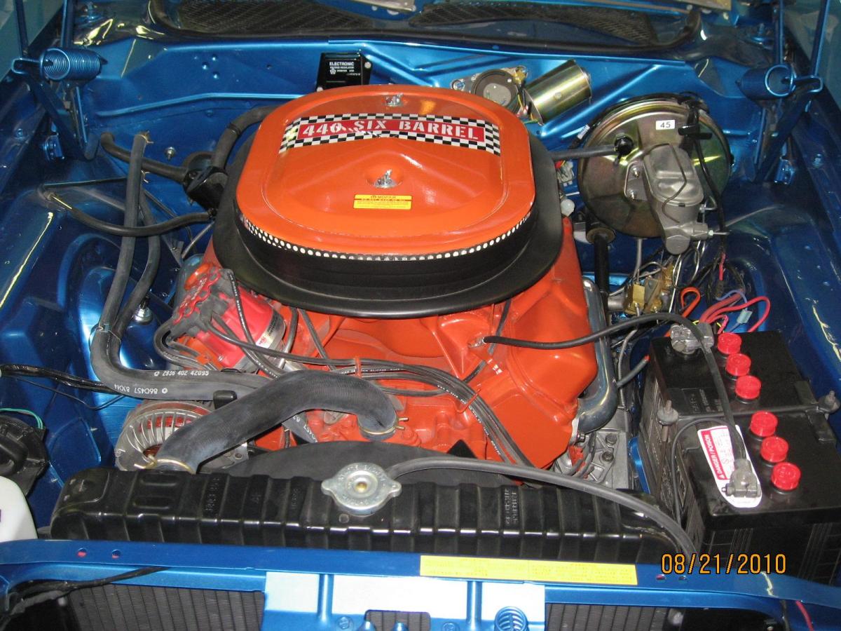

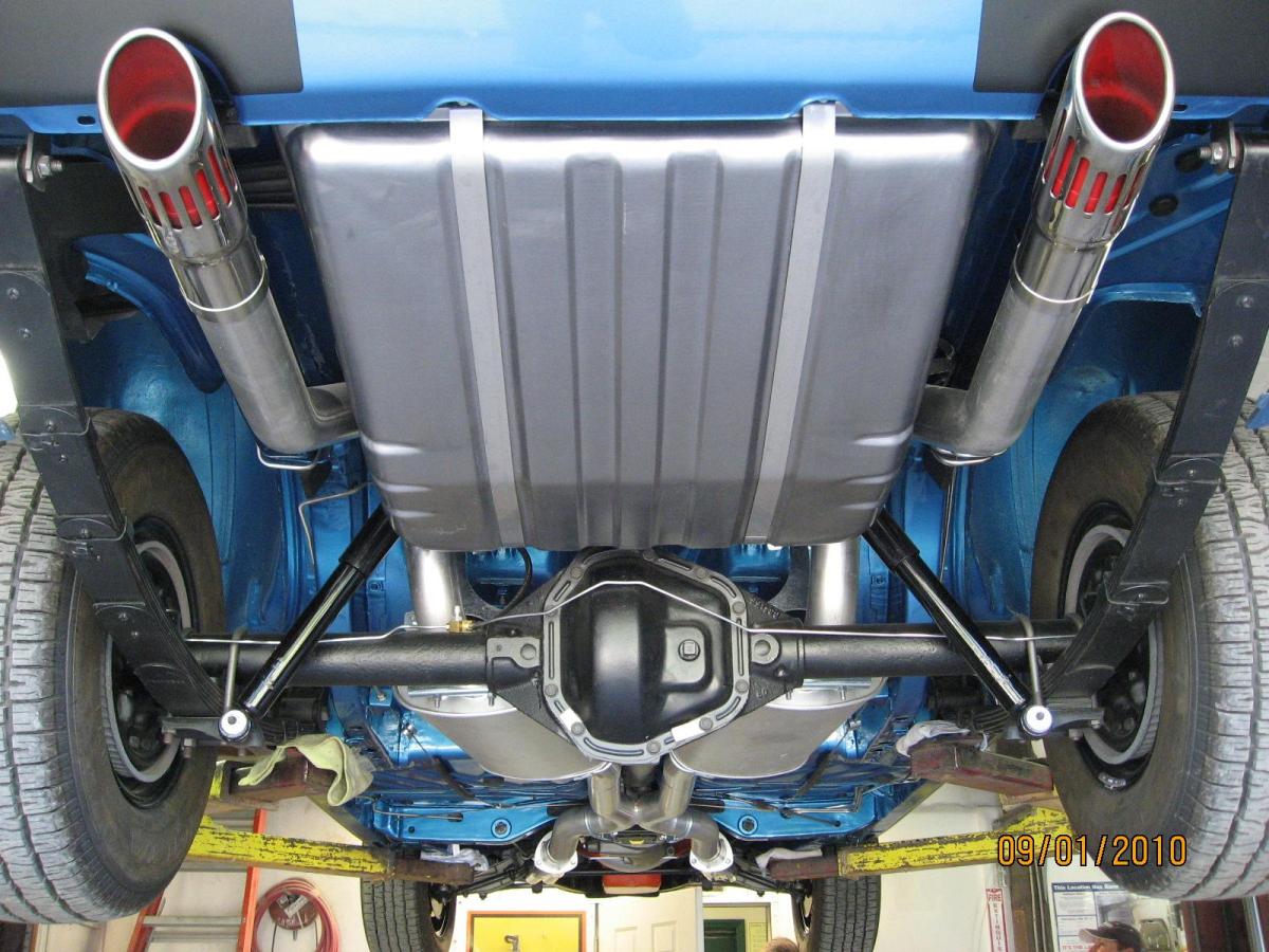

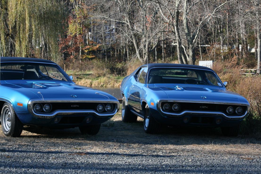

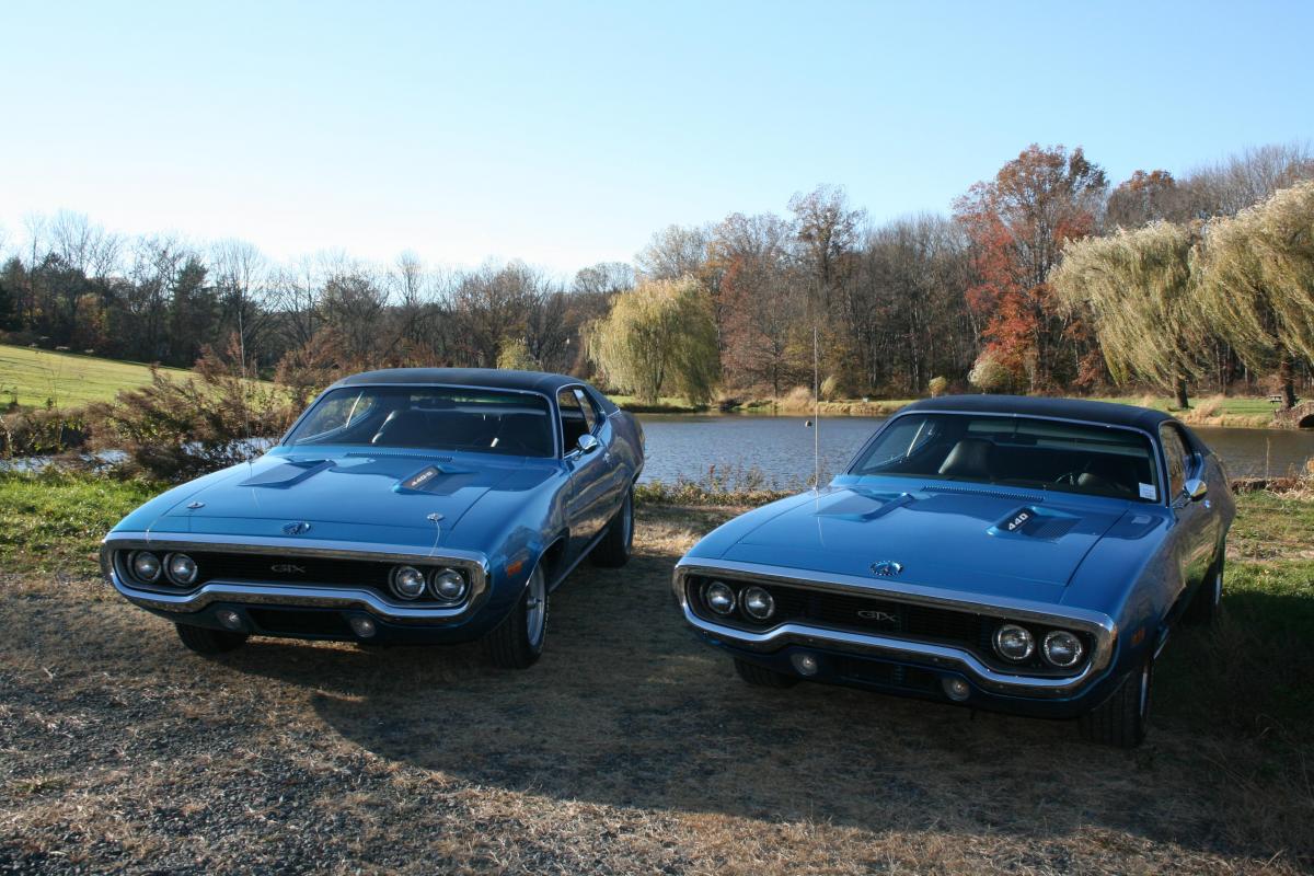

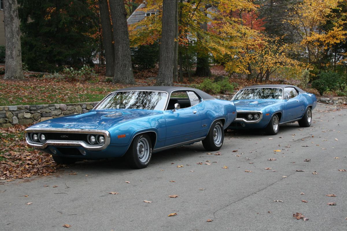

I read your post and noticed the back end of the GTX and recognized it immediately. Everything I said about the car is true. I drove that same car back in my college days and it is now owned by my younger brother. In fact, after he restored his, I found and restored a nearly identical one....same color, vinyl roof, 4-speeds...their twins. I'll attach some photos.

Wow that is really amazing! I love your photos and i will be saving those for reference. Im 23, and bought my "Satellite Sebring Plus" 4 years ago with my life savings...literally. I always wanted a GTX but for an 18 year old to buy one....yeah right. I made due with what I had. It was a 71 Sebring Plus 383 2bbl, Blue on Blue with a black top, just like yours up there. I've been hunting and searching and having success with finding almost every original piece of option that would ever belong on a GTX. So far, I just got the car out of the paint shop after a year, and am putting all these parts I've found back on it. Rear Defoster, Air Grabber, Speaker Fader, am/fm, hood pins, Six Pack, Deluxe interior, PolyGlas spare tire, A rare defogger/speaker adapter AND these damn "belt moldings!" (so THATS what they are called) I pulled them of a burnt up satellite a guy brought to Spring Fling in Van Nuys last year. I love them, and want them on my car, but mine never came with them, and dont have holes, or studs for them. All I have are these trim pieces, and some retainers that I'd have to drill holes and bolt down. Im just not sure if they belong on the outer edge, or inner edge, and how they attach to the rear quarter.
