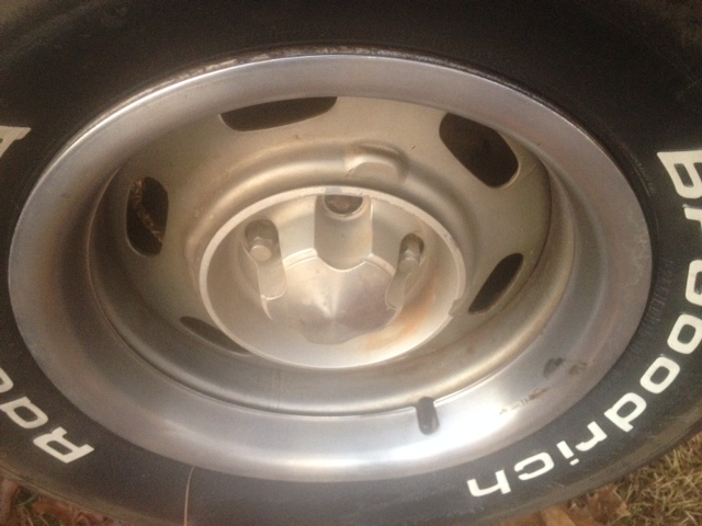

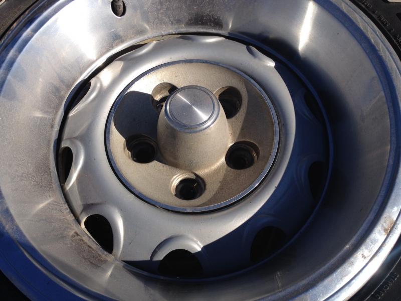

I'm neck deep in restoring my 1972 GTX and purchased a during my never ending quest for parts I found a very solid 71 Satellite Sebring that I've been driving around and having some fun with until my 72 is back on the road. It appears that the 1971 Sebring has 1972 center caps and the my 1972 GTX has 1971 center caps. I want to confirm my suspicions before I switch them around. The caps that rise above the rim on the BF Goodrich tires are on my 1971 and the ones that sit lower are on the 72 GTX.
The cones are for the earlier cars. The ones on the bottom are '72-newer.
FYI, the later style centers do not fit well on the police rims. The earlier style will sit flush on the police rims. The later style will sit flush on the ralley rims.
Thanks , which ones are on Police Rims? I want to make sure I have the right combination on my 1972 RR GTX. I'm planning on selling the 1971 Sebring driver in the near future and I'm going to keep the correct rims and caps for the GTX project.
