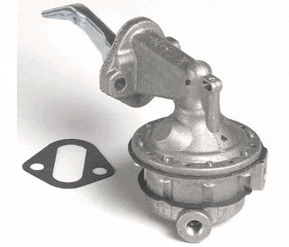

The original fuel pump in my 1972 Road Runner GTX 440-4bbl has died. Since the car is 90+ original, I would like to know if anyone rebuilds fuel pumps. If not, what is a good choice that functions and looks like the original pump. The stock pump specification is only 3.5 to 5psi. Any recommendations for a rebuild or a good one to buy? Thanks, Davison
Use the 6bbl pump, originally it was a carter and it's rebuildable. Mancini has them in a 5-6 psi and an 8-9 psi.
