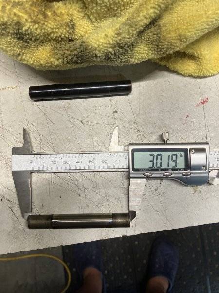

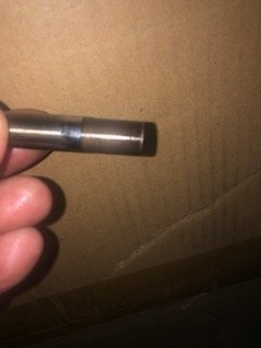

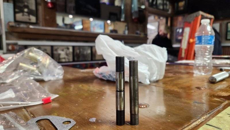

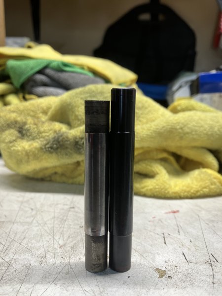

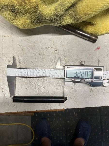

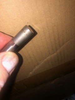

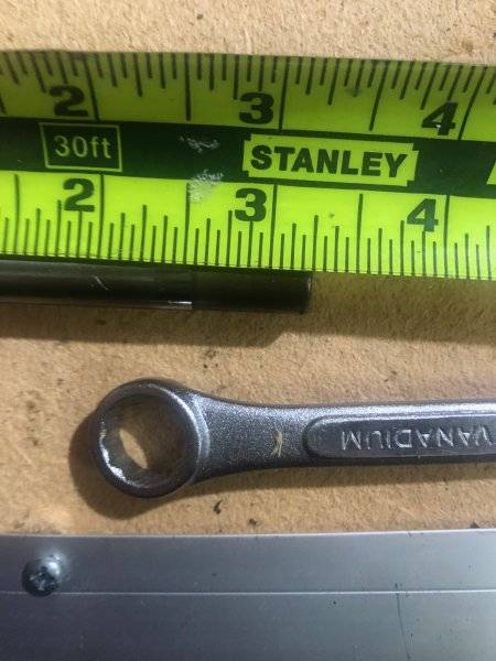

These pushrods wearing out, sure seem like they're made of softer steel than NOS/OEM.  That said, its better for the pushrods to wear than cutting a groove in the camshaft.  Perhaps, it's by design.
Is spring tension from the pump at all a factor?  Could that be out of spec?  I've several engine examples where the engines are several 100K miles and little or no pushrod issue.  I've reused these pushrods in a rebuild a  number of times, and I cannot recall ever  having to replace one after a rebuild.  Am I just... lucky?
