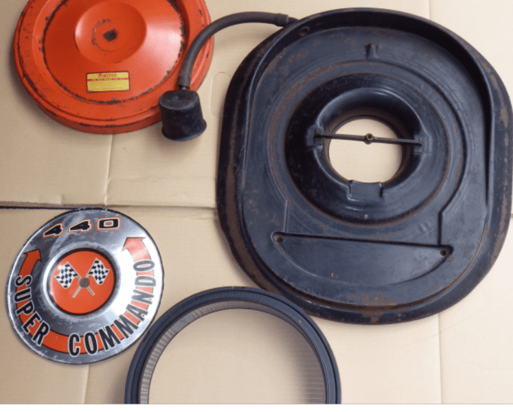

If it helps, what the '72 base looks like...............
And the drain tubes under.........
Thanks ish So I guess that is maybe part of the answer that yes it will leak water on the engine?
Mine did as I recall from way back in '77-'78, but it wasn't anything major.

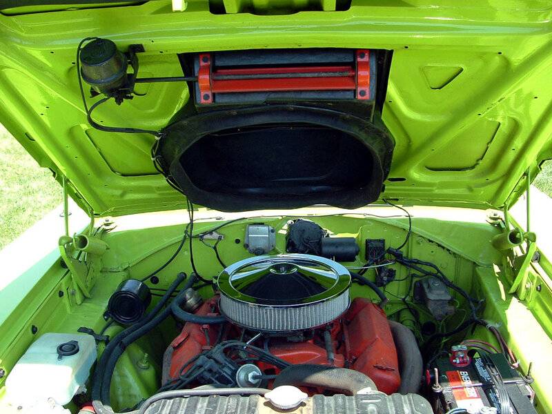

Thanks.... Here is a picture I found on this forum but the discussion wasn't about my questions.
Can I go higher w my intake and close the hood? Will it leak? It looks like a 14" type air cleaner fits?

I’m pretty sure a 440 with that intake will not clear if it’s taller than stock.
A 440 with a stock intake with the original 440 cleaner would, but 440 with 400 cleaner would rub the cleaner, or at least it does on my 70 RR even with the hood adjusted up in the back.
The 440 sits taller than a 383/400. That’s why it’s called a RB it’s a raised block.
The system was designed for the stock setup to seal, so not much wiggle room.
IMHO I’d run a stock height intake and correct cleaner in order to have the air grabber setup over whatever power gains the RPM provides.

Ok. You may need to get a drop down base or "recessed" base for the air cleaner as it's a number s game as to when you break the air box shutting the hood...
