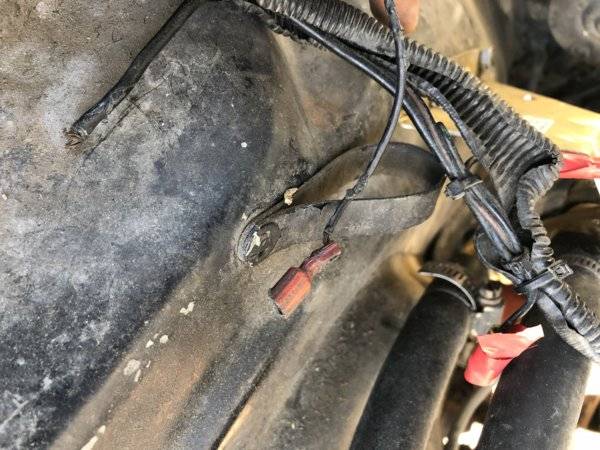

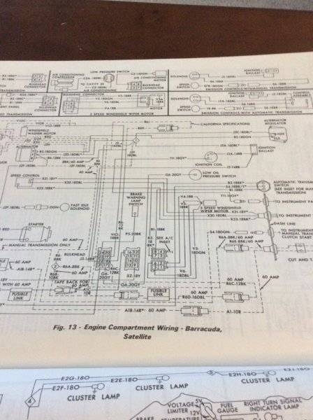

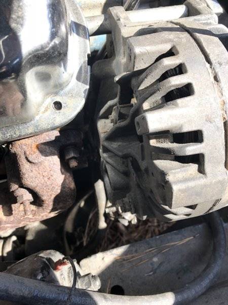

Just realized my battery wasn’t charging and noticed that the alternator has NO lines connected to it. Harness is kinda cut. Anyone have pictures of their 72 alternator wiring or a wiring diagram for this year SB Satellite? I attached some photos of my problem and what i think might be the connections for it.

even this wiring diagram includes ignition section, you need just to take care of the alt and reg wires:

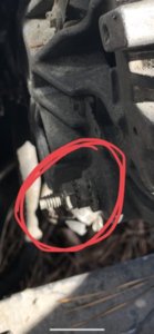

So what runs to this point? The thick black wire?
OH, and of course, thick gauge black wire ( stock is 12 ) eyelet terminal FROM ALT POST UP TO AMMETER, factory did through the bulkhead. that's the positive output to the system. Negative goes through chassis/body
yes, but without the other ones, that stud won't have any juice coming out from it
