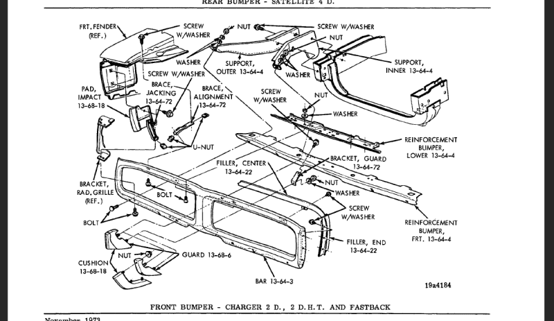

Put the entire assembly together with grills and brackets, then it slides in as an assembly and bolts to the front sub-frames with two bolts on each side. There should be (assuming the same as a '71) two small brackets on the top that attach to the front fenders. It's all pretty straight forward when you do it as an assembly. If you try and do just the bumper (front or back) it borders on impossible.

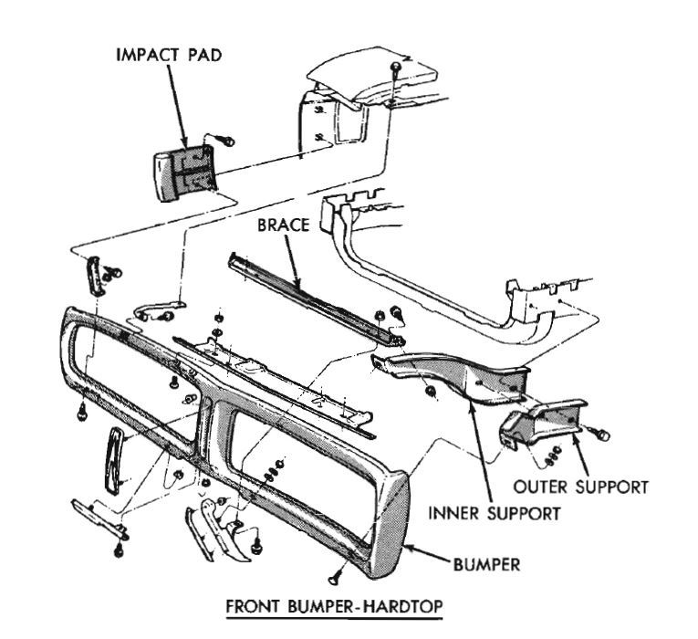

How is this?
Ahhh, That bolt toward the rear of that outer support, there seems to be no threads in my subframe, is something missing?
There should be threads in there I can take some pics of my car the bumper is off and brackets are still on it you need help just p.m. me I will try and get pics if I can .
The one has threads, but toward the back, it's almost like the spot welds have let something go on both sides.. Perhaps I could hold a nut in there when the time comes to install the bumper.
