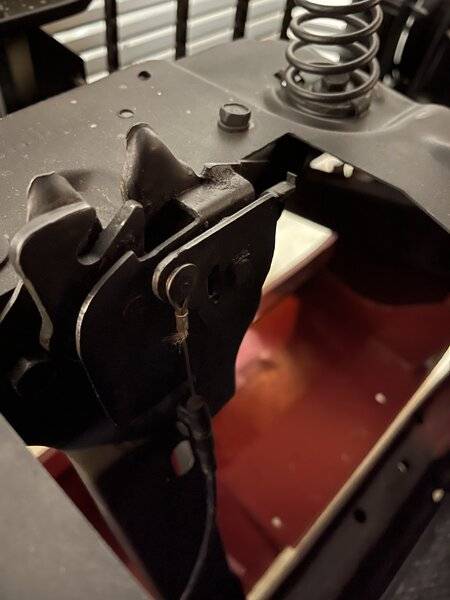

Anyone have a picture of the hood latch showing how the cable routes and mounts on to the latch? For 71-72 Charger with “loop” end cable.

If it has the cable with the “loop” end I’d love to see a pic of the locations the cable mounts to both the latch and the latch mount/support.
One way or another, I’m going to mount this new hood properly.

loop side of cable comes from drivers side hole behind light buckets' assembly, front to back of center brace and loop goes over "disk" on latching mechanism; ball end for pull assembly
Thanks! Appreciate the information. :)

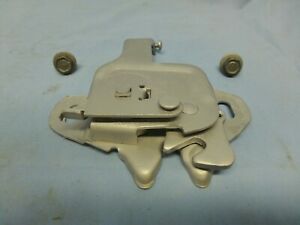

That latch looks just like the one I bought off eBag not too long ago. Same color and drop cloth actually, no sheet metal screw though, lol
Charger and Satellite use the same latch and cable but the latch is mounted differently on each. Is the same for 71-4. The above pic is correct for Charger.
