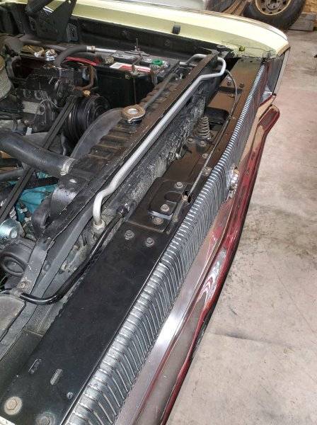

Offside, one of our 66’s has a metal block off plate so it cannot be opened from the grille side.
Now you are unoriginal heh heh. Very good idea! I will still use our lighter socket to plug chargers phones in. But could plug into the rear one.

I posted picture of one of our 66’s with the block off plate to prevent opening of the hood. That was on Sunday in the 66-67 category.
