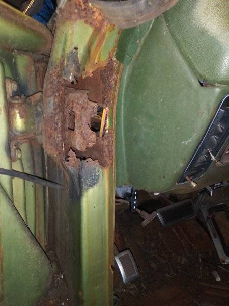

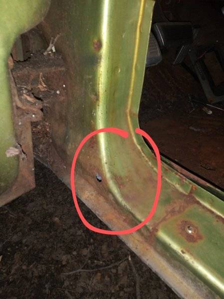

This is the drive side jamb behind the hinge top and bottom of jamb which I can probably fab a price and patch it.
Are they replacement panels or cut from a charger? . I posted pictures in a reply to another member. Take a look. I'm not a body guy. I know it can be fixed but not sure how difficult.
All my stuff is original drilled from desert cars. Your hinge jam would be alot easier to weld in a patch piece or or complete jam. It is rusted right at the hinge area. I would probably just patch it with a piece form another jam. Replacing the whole jam is difficult with how it is welded to the rocker.
I'm thinking the same thing.
From the vertical seam forward towards the hinge are solid. The door is secure with no flex even when applying pressure up and down on the open door. What is the price? I think I only need the driver's side. I have to poke around the passenger's side to make sure it's solid.
