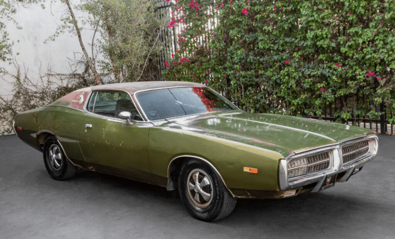

This is an SE

Mine must be called a hard top. QTR windows roll down and the qtr window shape looks like the coupe and hardtop
