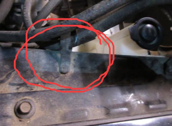

How does this plastic loop open?
Snaps together, carefully pry up the upper end from the lower, the strap secures the E.C.S. hoses to the charcoal canister, no EGR system in ’72.
