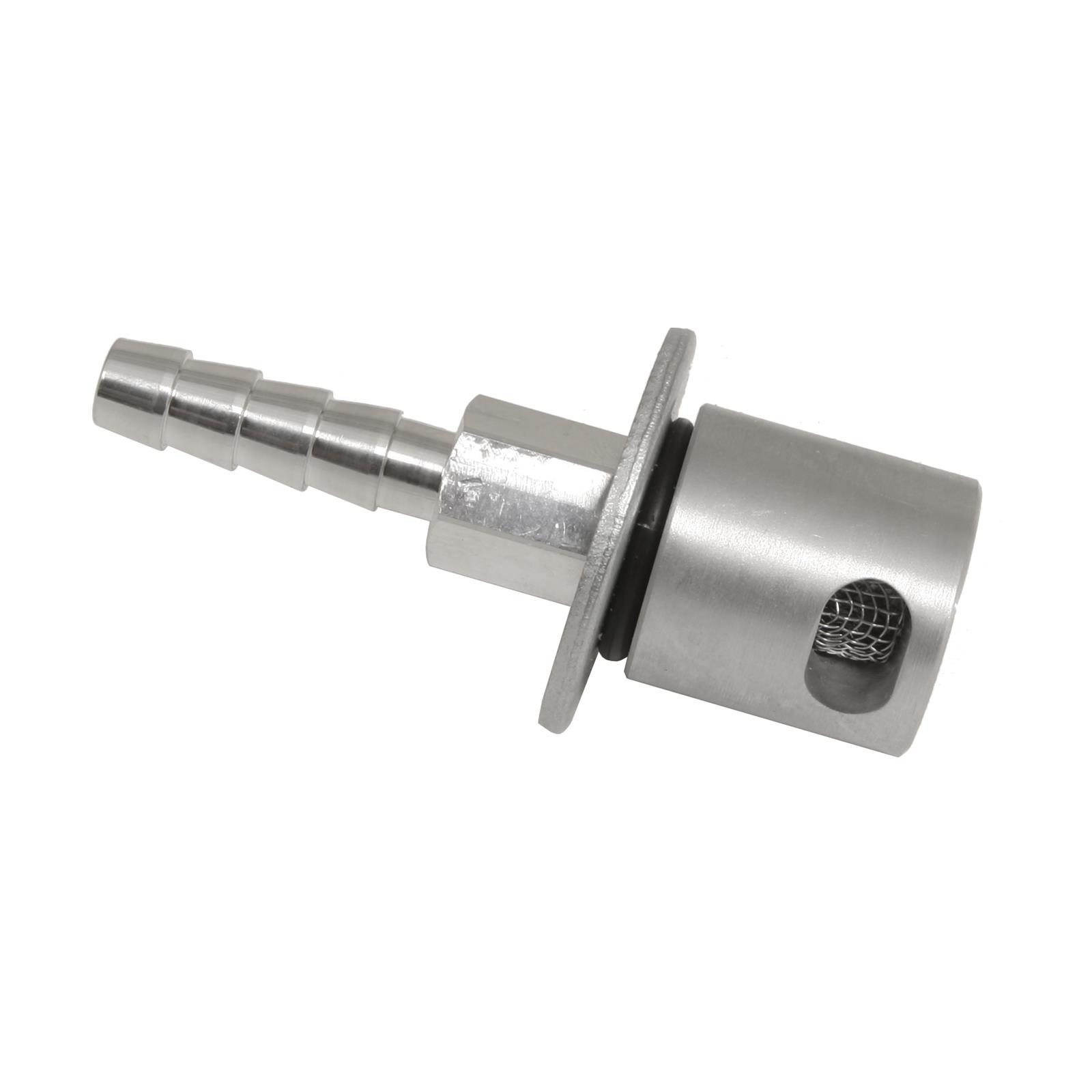

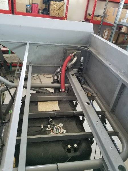

This pic is on a custom build
that utilizes a Corvette brake
booster charcoal filter.
$10.00 at your local parts
store plus a bug screen
typically used on a boat.
There are zero gas fumes
where this truck is parked
indoors.
Shown to the right of the bed
support.
