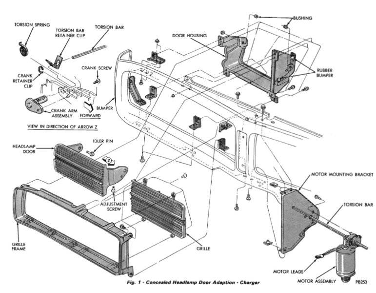

-You need to find all the Hideaways setup... Grilles, doors, motor, doors rod and all related brackets.

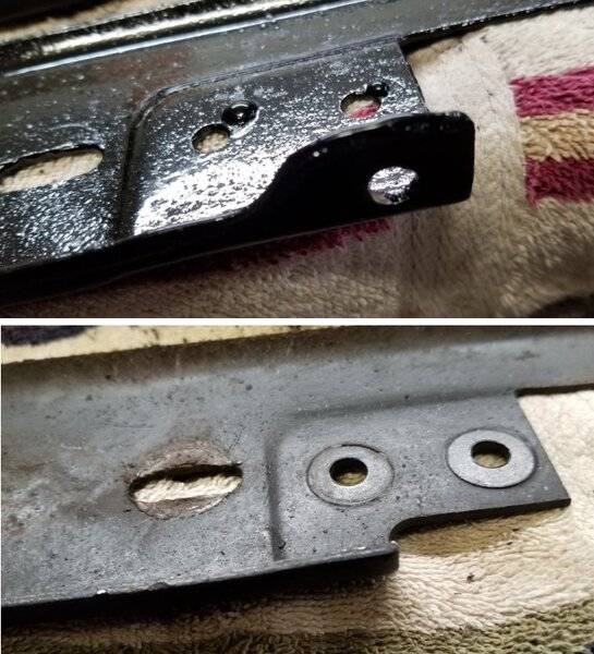

-For safety, is better or nice also get a beam reinforcement which attachs on inner brakets of the Y bumper brackets of the 71/72 ( not used on 73/74 ). This will require drill some holes on Y brackets too. NOT MANDATORY FOR THE ASSEMBLY but better for safety in a crash incident.

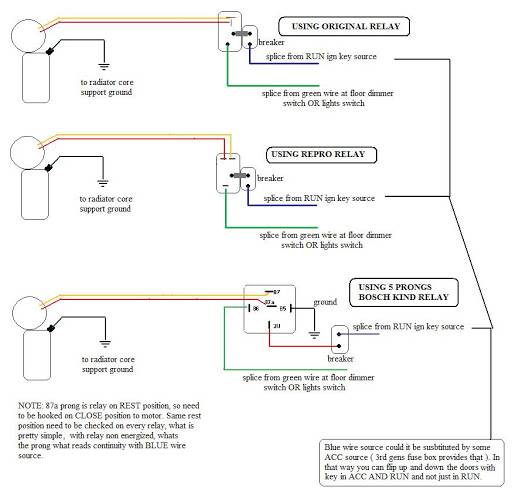

-Wiring, relay... can be made at home althought some reproductions are available. But you will save A LOT making it by yourself. Is really easy to build and just need a Bosch 5 prongs relay, safety breaker... plugs, wires and a grommet to go throught the firewall. Somebody around ( I think at dodgecharger.com board )used a Ford relay really similar on how it looks to the original Mopar one and the PN was posted on the thread, however, being the regular relay available anywhere around in the world and CHEAP, I wouldn't worry about.

wiring diagram ( this is one I made long time ago and has been shared everywhere ):

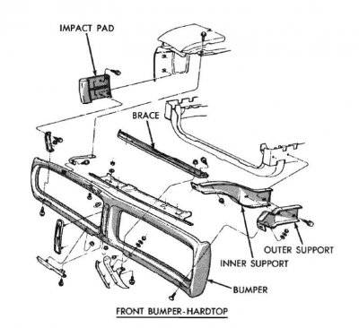

The inner Y brackets brace used on 71/72 but replaced by the bumper mounted on 73/74 ( both to frontal impact protection ) is the one labeled here as BRACE.

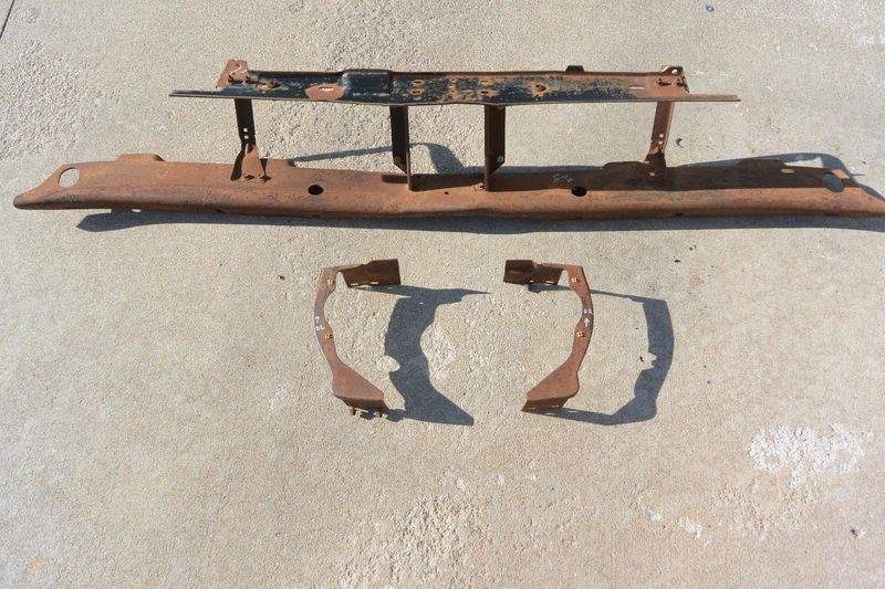

The diff on top bracket reinforcement is this, WHICH some 73/74 STILL got the provision, My 74 did, but my car was assembled in Vzla so maybe is not the best example, however A LOT of 73/74s I have checked in USA still got the earlier kind. So will depend on your own car. This provision can be also build and welded!!!

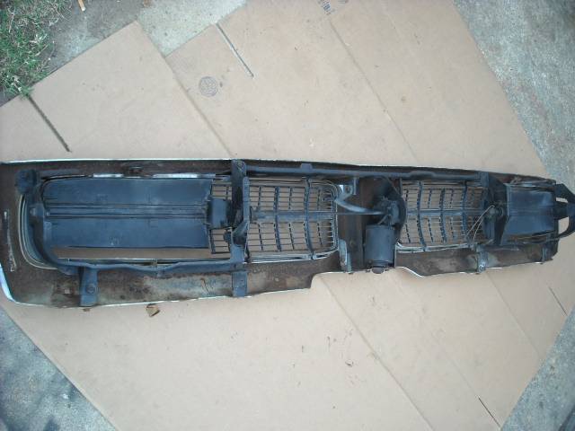

and this would be the full view assembly:

This would be the 73/74 bumper reinforcement setup. You can see the bottom beam what needs to be removed and the top one earlier kind with the provisions for hideaways brackets setup
And how it looks a hideaways system installed from the back, and the reason why the bottom beam needs to be removed for clearance for the hideaways bracketing.
