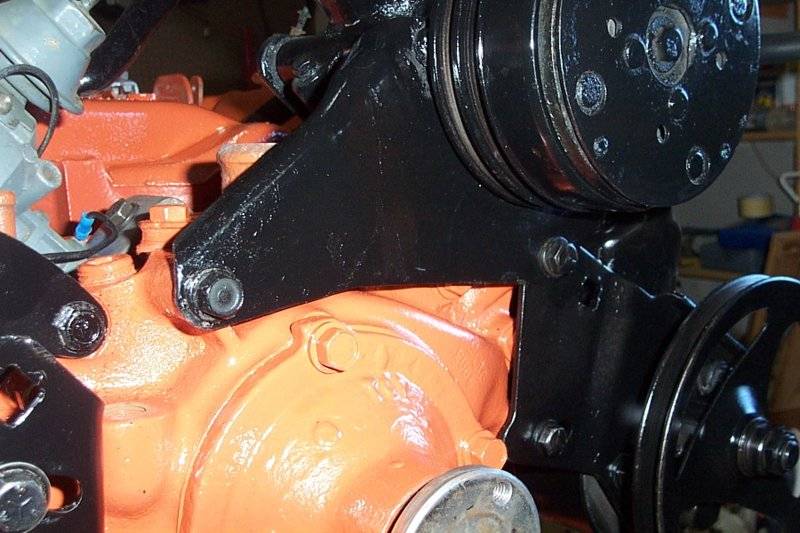

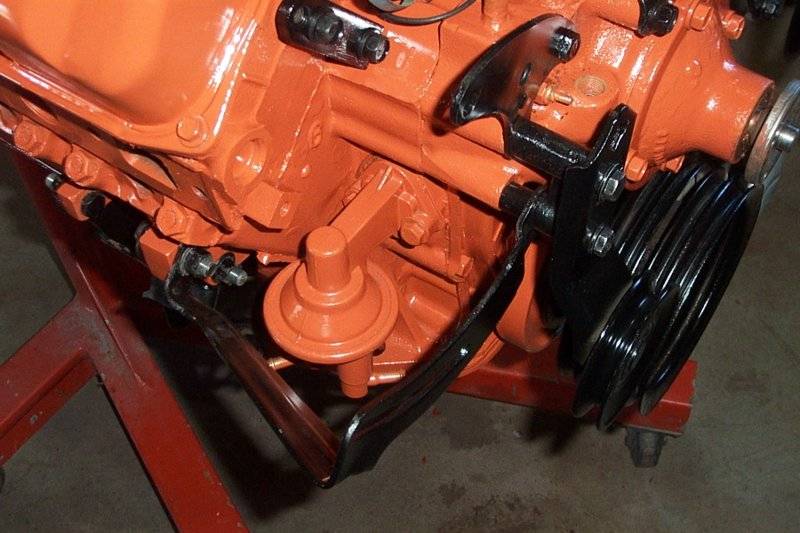

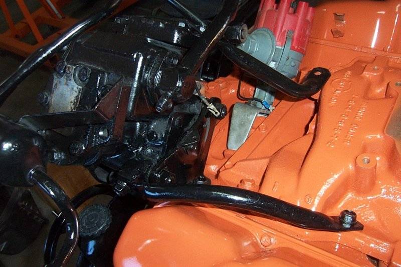

I'm putting my 72 roadrunner back together, however I can't seem to find a picture, let alone the correct rv2 compressor brackets for this model. Please no sanden brackets. Any help would be greatly appreciated !!
1972 rr, 400ci
should be the same set up as any A body,truck or van. I'll see if I can locate a pic
Thanks for the reply, however small block will not fit my 400. I am looking for 1972 400 ci
This is a 71 383 but is the same as 72 400.
Truck and van are different.
Thank you moparmarks ! This is exactly what i am looking for. Now I need to find this setup for sale. I have the idler and alt. brackets now to find the other pieces.

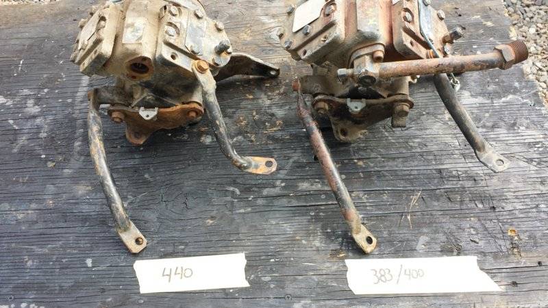

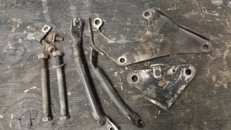

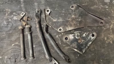

Here are the mounts that I came up with for you.
Also 440 mounts for people to compare with.
These fit 69-73. Think 68 is the same.
The front plate is the same for 383/400 and 440. The rear plate and two bars are different.
74 has a completely different mount and pulley setup.
