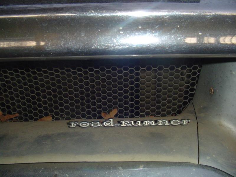

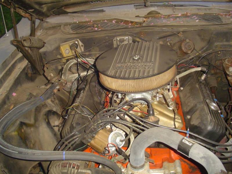

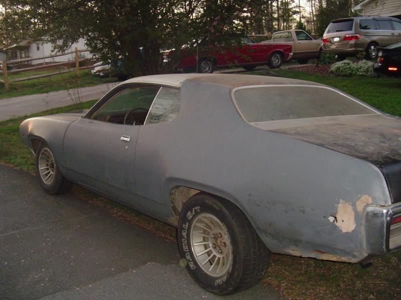

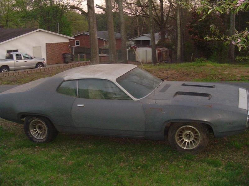

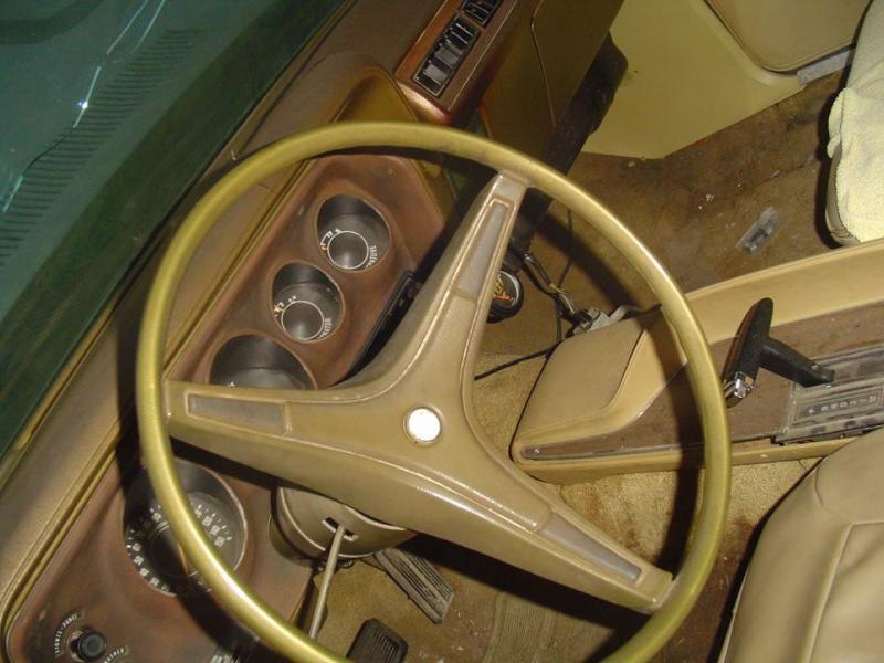

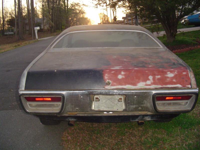

Greetings everyone. I have an interesting story and would like the opinion of everyone.
When I was younger, about 8 years ago, I enlisted into the military and recieved a nice little chunk of change for an enlistment bonus. I decided to follow in my father's footsteps and purchase a Roadrunner that I could restore along my military career so I could have a nice car when I got out.
So I purchased a 1972 RR with the RM tag (as he said) from St. Louis and had it shipped to NC. When I got the car, I started looking around and it looked just like he said with everything stamped Roadrunner; however, the title (once I got it a couple days later) and the vin tag on the dash had RH codes for a Satellite. At this time, I was irrate and calling the seller to find out what was going on because I purchased a Roadrunner and not a Satellite. Come to find out, the guy found this "Roadrunner" in a friend's garage who he had done some work for. The guy could not pay him so he gave him the Roadrunner as payment. The roadrunner didnt come with a title so he purchased a dash board from a junk yard that came with a clean/clear title BUT.. it was a Satellite dash and title. So he put it on the Roadrunner and called it a day.
I have the original dash (I believe) with RM codes. All the stamps throughout the car were checked out as a Roadrunner. Would you keep it the way it is? Swap the dash out and try to get a salvage title? I am curious to hear what people think.
Disclaimer: I purchased this car almost 7 years ago and it has sat in my garage ever since.
