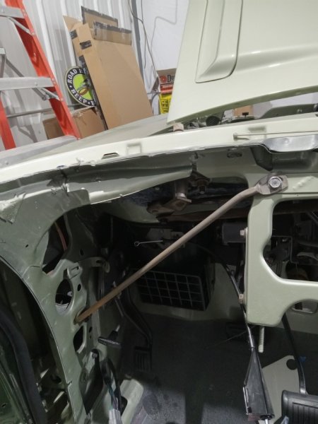

does anyone know what and where this brace goes? I'm reassembling my 68 roadrunner and I had thought that it was a bracket/brace for the clutch pedal assembly...to long to fit anywhere there though. could it be a brace for the dash somewhere? to long i think for anything like that too... I'm stumped

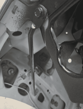

Goes from the top left of steering column support to the panel on left where your kick panel is right in front of the e-brake set-up...
