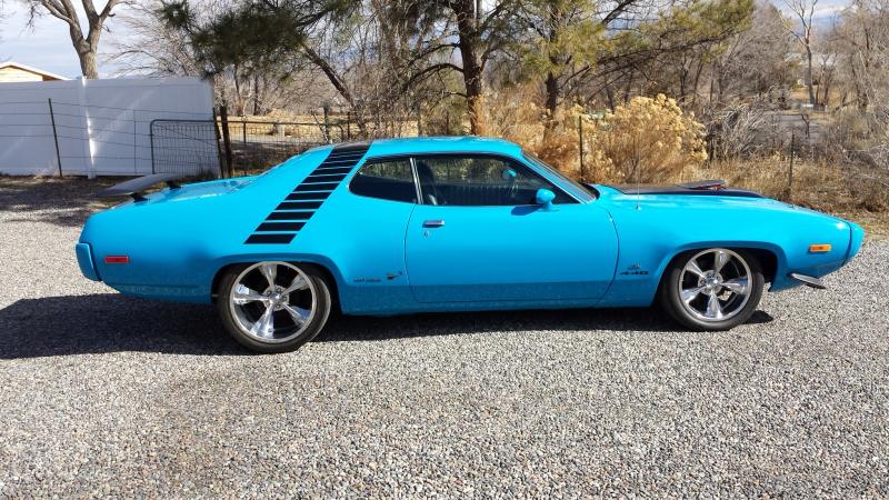

Here is a customers 72 RR/GTX with 18 and 20's. 2" drop spindles and 1" bars up front and 2" blocks in the back. I'm not a fan of lowering blocks though.
