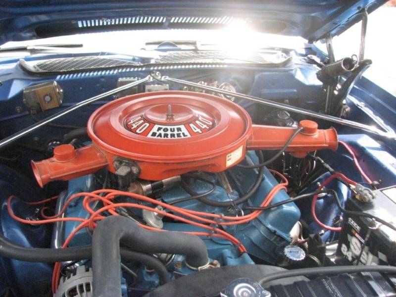

from my experience the 72 cars had the bent bar on the pass side on both N96 and all big block cars..Ive seen straight bars on both sides of Chargers and 73/74 road runners..I have replaced this 73/74 air cleaner with the proper one since buying this car (equal size snorkles)....Anyone need a mint 73/74 air cleaner, freshly powdercoated??

I have a pair of these rods in the parts pile stored in my motorcycle trailer for the winter. I assumed they came with the car, but mine is a 71 Sebring. Pretty sure they were straight. (must be from a Charger???) I was planning on using them, they look good.
My SB 340 72 RR has them and they are the originals since new also a late build if that matters. They have the bends for the N96 eventhough I dont have it.
