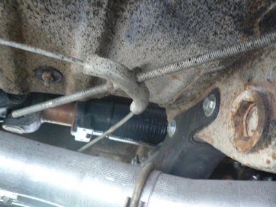

I believe I'm missing the emergency brake adjuster bar and whatever screws onto the threaded end that holds the cable (In the picture) almost directly under the front passenger seat on my 72 satellite but I'm not sure how it is supposed to hook up. All I really need is a picture of how and where it is hooked up. Thanks

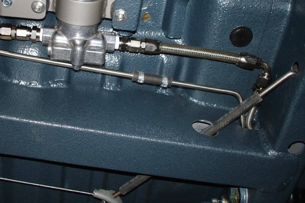

I actually moved mine to the hole where the fuel line passes through but the org location was just a little further to the (passenger) side of the vehicle but my subframe connectors got in the way. Ill go get a pic in a hr or so.

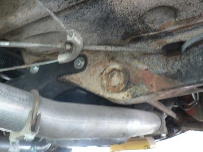

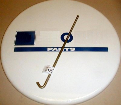

thats the pic of it with the hinge peice that turns the line towards the rear right brake drum
