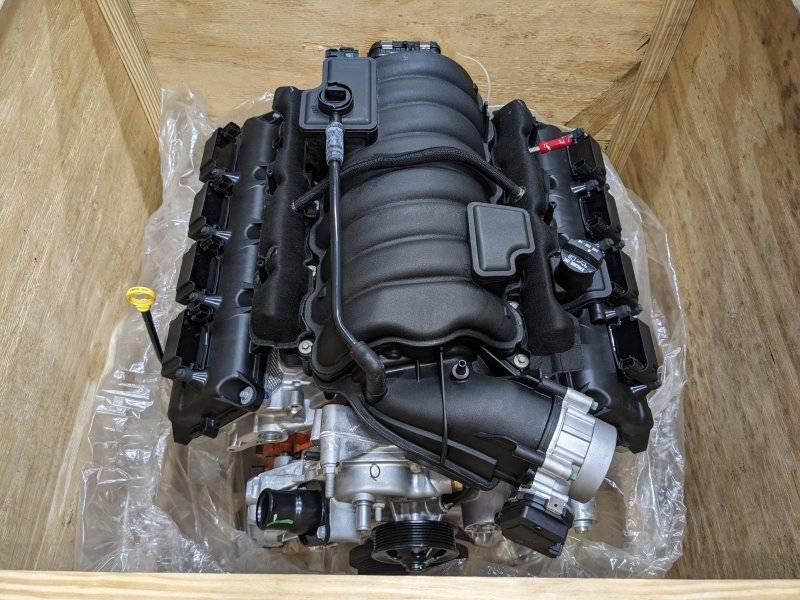

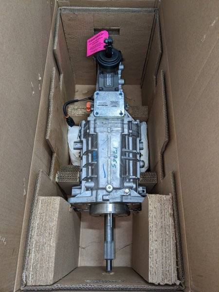

I've been talking about doing this for well over a year now, but now the ball is finally rolling. The car is a 72 SSP, the original drivetrain is long gone. Right now it's got a 318 with the 3 speed auto. The car was restored in 2021 to be a driver quality car with some flaws here and there, but I was looking for a project anyway. Here's the plan:
6.4l Crate Motor
TKX 5-speed

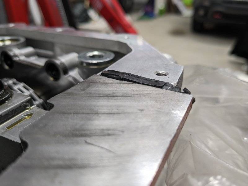

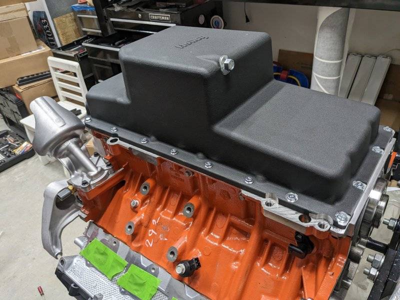

Halfway through my oil pan install and noticed one of the rubber inserts is sticking up pretty high. I'm worried that might cause a leak. I'm debating leaving it alone, adding some RTV there, shaving down the rubber a bit or some combination. Thoughts?
The rubber seamed to be able to recess under pressure so I put some RTV on the T joints and sealed it up. Also got the 45 degree oil filter adapter in. Not sure why but the Holley pan in black was cheaper than the natural one. Oh well, looks good.

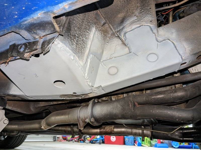

Subframe connectors are installed. In addition to the level one kit, I also got the front lower braces. I had a local shop install them for a very reasonable price.
Also I took these fuel/brake line brackets off beforehand and reconditioned them to go back on and I think the torque boxes cover up the attachment point. Does anyone have a picture of these installed for reference?

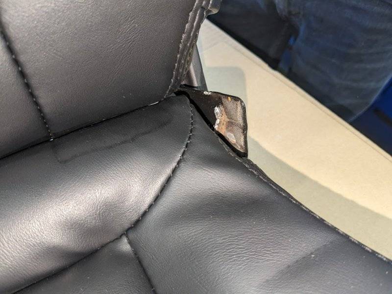

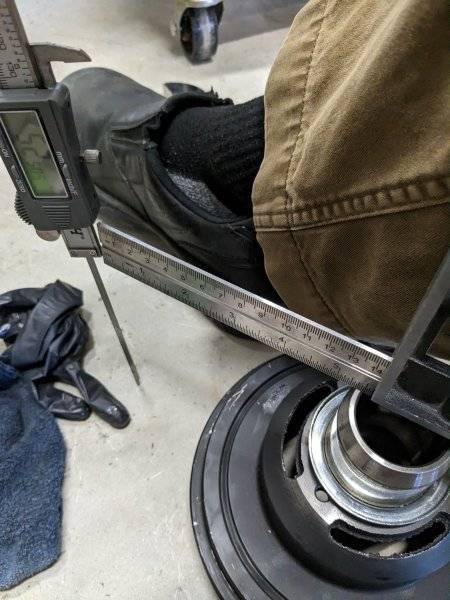

It's been slow waiting for the replacement crank pulley, but I should have that mid week. I'll also evacuate the AC coolant this week to prep for pulling the engine. In the meantime I pulled out my new seats to try them out. One of the hinge welds was broken out of the box. Better now then in an accident I guess. They seem comfy though and look good.
Got my accessory kit installed with the replacement pulley arriving this week.

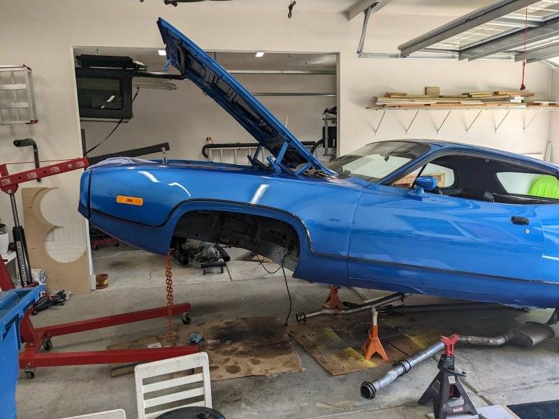

I got the AC system evacuated so now I'm free to start pulling the engine. I might have to cruise a few more times though before I dive in though.

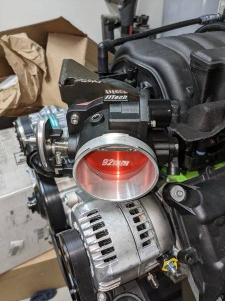

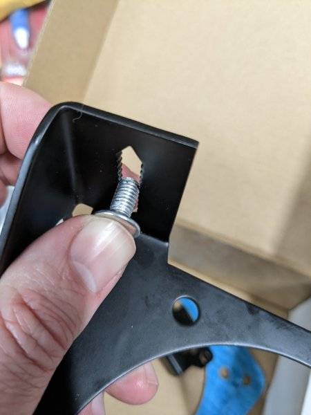

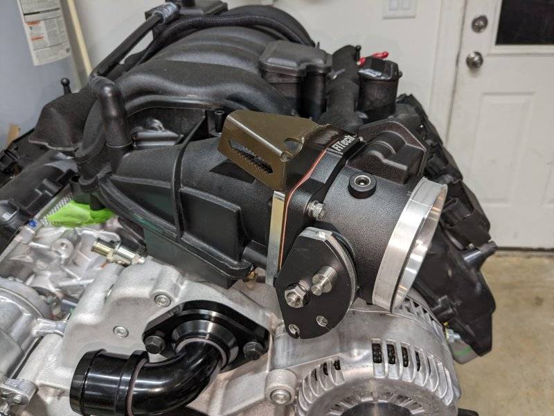

I picked up a Fitech throttle body and cable bracket, but the bracket was made wrong. Got summit to send me another and it was also wrong. Waiting on number 3 from a different warehouse to see if that'll do the trick.

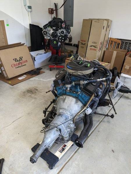

Also I have been working to get the motor free. Still need a little more altitude to get it out from under, but I'm pretty close.
Finally got the Fitech throttle body mounted with an adapter plate. The Fitech cable bracket was another story though. I have 3 of them now and none of them are made with the correct hole position or hardware. The saw tooth pattern is also too small. The powder coating is also way too thick. I picked up a Holley bracket and it worked as expected. The color is a bit brown though which is a little odd.
