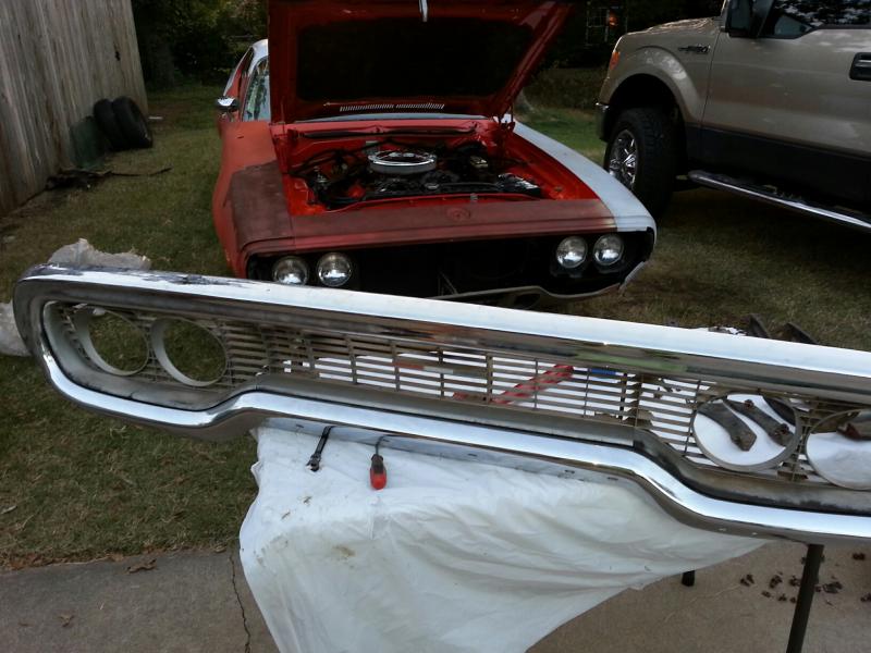

I'm trying to assemble the grill and bumper on my new 72 SSP. When I got the car all the pieces were in the trunk. I have doubles and triples of some pieces and think I have weeded thru thoses. I want to see if I have everything it takes to assemble bumper and grill before paint work. I have the left and right lower bumper brackets and bolts that go on the bottom to hold bumper... getting sand blasted now.
Does anyone have pictures of the installation process or pictures of how the grill and brackets go on? Schematics, drawings?
Thank you,
Im not seeing your black plastics (they surround the headlights) these sit behind your grill, or are they on the car already?

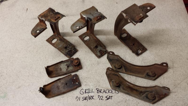

Here is the 7-piece 71 grill mount
The two black bars in the front of the pic look like they are for the A/C compressor. The 90* piece of tin to the right is the shield for the inside hood release, Plymouth only.

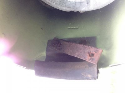

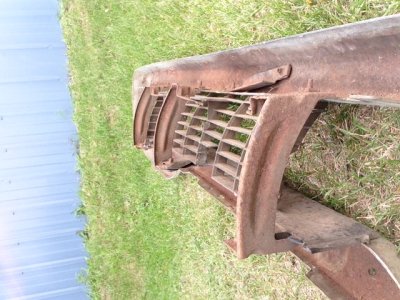

there is a bracket on each end bumper that goes to the fender and another one top dead center. Thought I had pics. Still looking.
fender tabs, and grill shots
