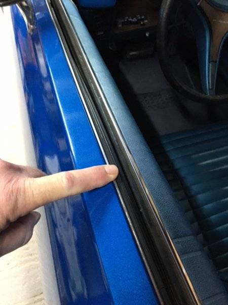

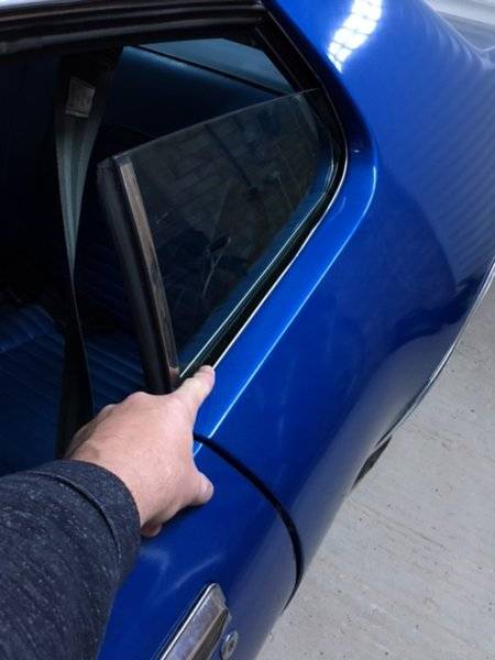

Hi all , firstly many thanks for all of your information and taking the time to help me - greatly appreciated .
I have added 2 pictures of the exact pieces I need and will require a trunk seal
The pieces I need are being pointed at in the pictures , thin pieces of rubber at the tops of the doors and the same where the rear windows seal against the body work ....
