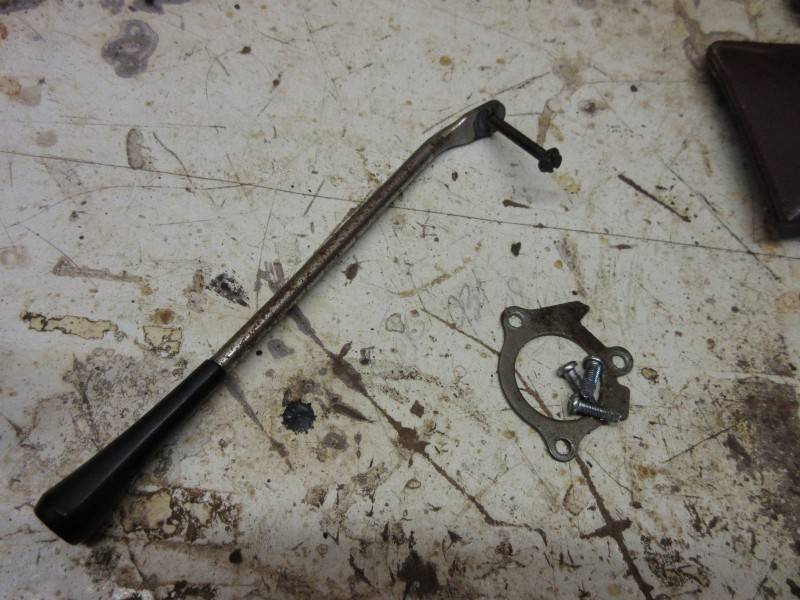

I was thinking of replacing the rusted turn signal lever, but $40 is the best price I've seen on these. For that price I think I'll clean the rust off and paint it with clear.
