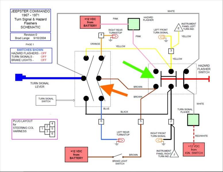

I tried to find a Chrysler specific diagram, but this is the best I could do for now. It will give you an idea of the inner working of the switch. Check for continuity like from the brake light feed to the left and right brake light.
The side markers coming on with the brakes sounds like a ground issue on the tail light housings causing backfeed to the side markers.
Check that the hazard switch is in the right position and maybe cycle it a few times to make sure there is good contact.

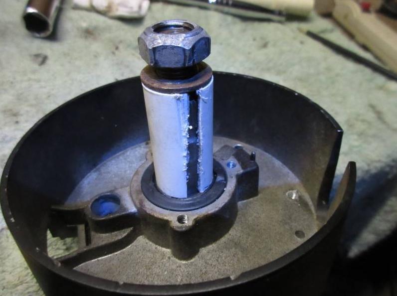

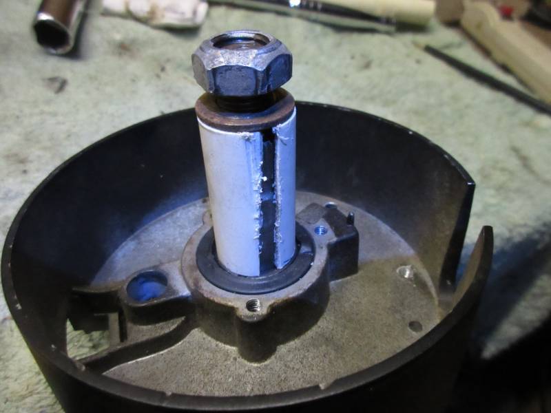

The horn button is contacting the honker ring in the steering wheel. I pulled the wheel, put a dab of Noalox on the turn signal switch button, put the wheel back on, took it off again and the Noalox had transferred over to the wheel.

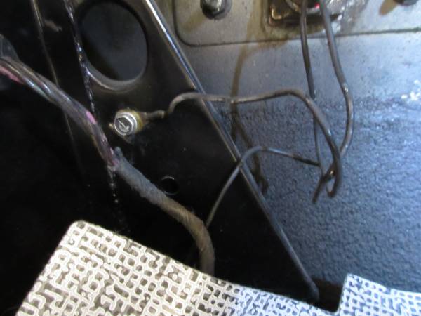

I'm sure you're right about the ground - question is, where is the ground I'm missing? I've got this one -
Odds are your 71 RR's wiring harness is the same as my 72 Charger's, so if you know where your grounds are maybe we can figure this out. I've looked at my harness a couple of time and if there's another ground I haven't spotted it. I thought it was strange that there would only be the one little ground, but what do I know about electricity? Not much.
