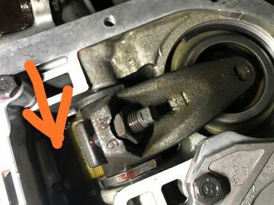

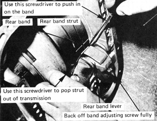

If your talking about the band strut which I believe you are it goes in after the pin is in place...
Make sure the adjuster is backed out so it just locates the short lever but doesn't have any further travel.....Rotate the band so it catches the anchor, then use a long thin screwdriver apply force to apply the band.. & slip the strut into place.... You only need six hands & the key is how you hold your tongue.... LOL

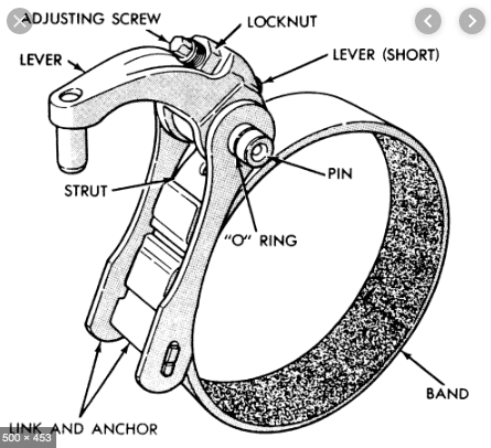

Yeah, don't try to put everything together at the same time. Install the pin and then install the strut after all the other parts are in place.
