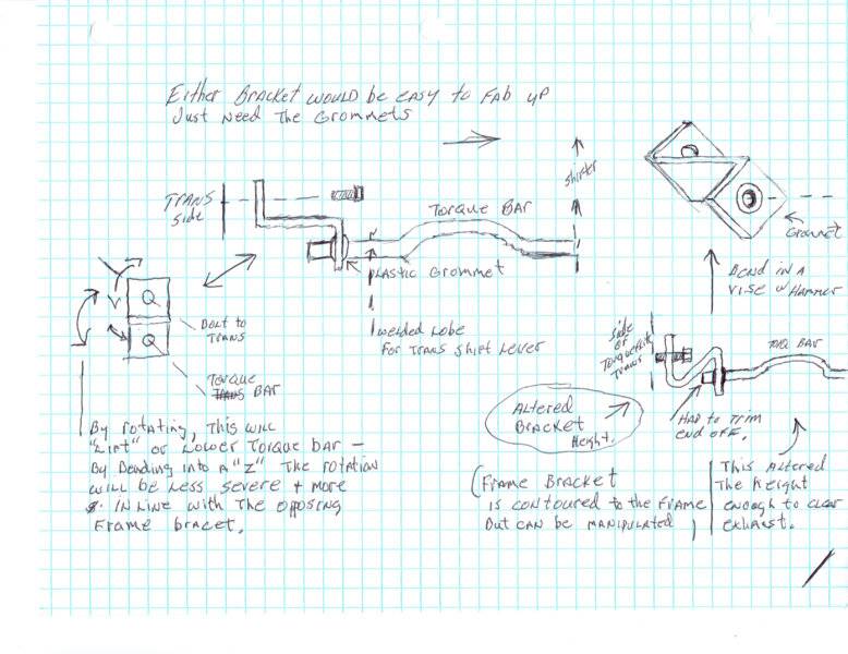

So far, so good on the trans rebuild. Can anybody recommend a good column shift linkage kit?
The previous owner modified the lower brackets to get above the header collectors, and I cant figure out exactly what they did.
Ididit makes a "cable" conversion kit to replace the linkage, anybody have experience with cable conversions or work arounds? I've got the "throttle kick down" converted to cable already. It's nearly impossible to get a smooth shift with the headers in the way of the torque shaft and chassi brackets. This photo is close to mine but the torque shaft has a slight "U" shape to allow for factory exhaust. Any insight to getting a good column shift would be appreciated.

It just dawned on me, what you were talking about... yeah , no, I'll have custom brackets made for stock linkage before ripping the headers out...I just need a respectable way to column shift a automatic transmission. the previous owner did a hack job on the shift linkage because of nice, but ill placed collectors.
I have an original stock set. PM sent
I would have to make custom brackets, which might be the right way to go, still waiting to hear back from Ididit co. for a cable kit. Thank you! I bookmarked your page, if thats the way I end up going.
Did this ever get resolved? I am having a similar issue of the transmission linkage hitting the exhaust downtube. I have the same "u" torqueshaft.
I tried unbolting the donut and moving the down tube up a little but no luck. I am running factory manifolds but it was a custom made downtube the previous owner fabbed up.
Also where is it suppose to bolt to the transmission?? I cant see any obvious place for the bracket? the bracket on there now is a hackjob.
Thanks
Sorry no reply...I've been off for a while. The trick was this: the mounting bracket that houses the u torque shaft on the transmission side had to be "bent into a proper "Z" from it's straight 90 degree offset...making the bracket shorter, if this makes sense. If you are still working on it, I will post a picture or at least a diagram. By bending the bracket at the 2 hole tabs, it changes the height of the u torque shaft so that it clears the exhaust. Mine was hitting the collector area at the end off the header. being custom, botched, headers, I'm not sure my work around will work for yours. Let me know.if any of this applies.
Hey thanks for the reply! Could you post pics of both the frame bracket and trans bracket side?

Ok. yeah. no room for pictures under the car. both brackets can be rotated up or down somewhat. Here is my mad scientist explanation diagram. The trans is a torqueflite. The bolt hole is "inline" with the torque shaft give or take a inch, or faces the frame bracket...if that makes sense. I have no doubt the trans bracket is not original and it surely does not look like the manual picture. The frame bracket is contoured to the frame, but can go in a few ways including backwards. Your goal is to raise or lower the torque shaft just enough to clear a custom exhaust, without altering the frame bracket. If I had access to a machine shop I would have fabbed up 2 new brackets in less than an hour...it would be super easy. Instead, I bent the trans bracket into a "Z" which I could rotate to get the best alignment for the torque shaft. Hope all this madness
will help!
