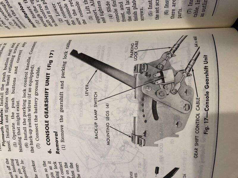

I am working on a 64 Plymouth sport fury and like a dummy when I pulled the transmission I didn't mark the posts on the shifter as to which one the shift cable connects I think it is the outside one.
can anyone help
I have the same car. I'll check the FSM for a picture or look at mine tonight if someone else doesn't get to it first.
Thank you very much. I have enjoyed some of your past posts. Need to get this thing running before I’m to old to drive it
Excellent the information I needed. Appreciate the help. Hope to get some pictures one day
