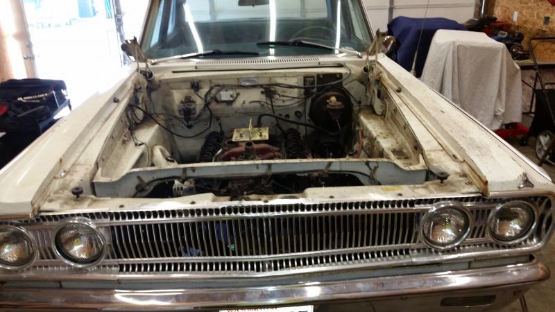

Hey guys I am a newbie have some basic questions. I currently have a 65 dodge coronet with a 318 block (1967-1975 casting number 2536030 318-3) bolted to a torqueflite A-727-A (dodge late 65 8-318 casting number 2466166). The engine is shot and I have a rebuilt cast crank 440 long block (casting # 4-6-77 # 4006630-440-4) that I would like to put in. Will it bolt right up to that transmission?
This is going to be a street rod, it's a four door *** hauler/cruiser
do I need to change the torque converter?
i need to get a intake, carb, distributor, dampener , what do you guys suggest?
Dang that sucks.... The guy I bought it from told me it used to have a 440 in in... The transmission seems to be original to the car, but the 318 came out of a 70's dodge van. The car is a 440 model. I'm confused and now it have a 440 long block that I can't use. What transmission would I need to find? I should just rebuild the 318 that's in it, it lost compression on a few cylinders.

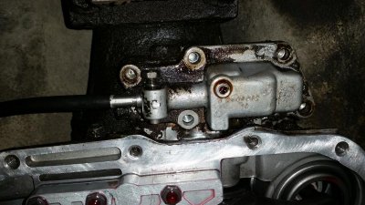

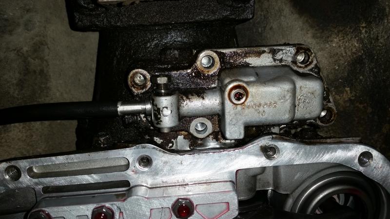

On my 727 small block, how do you get this control cable off? I've tried everything but I don't want to damage it. 20140726_102546.jpg20140726_102638.jpg
65 727 was cable operated shifter
you will not be able to use the the 727 you are getting with push button shifter
you will also have to make sure you have the correct kickdown linkage otherwise the trans will burn in up in no time
The early push start 727 had two pumps the regular one and a rear pump... it's a lot stronger and more buildable trans.... other than what bolts up the guts can be built.... if you don't study up on it you can waste a lot of money on stuff you may or may not need... a 318 poly to LA 360 would be my choice of conversion than the 440 because of all the work and a hoped up 360 would be easy power....
65 was also the first year of the slip yoke.
Do you guys know how that cable comes off? See pic. The trans I have in here is the 727 LA late 65, it has a shifter on the column and has two control cables. This doesn't have push buttons. So ya if I was to get a bb 727 I would have to get a non push button.
shifter is still cable operated if there are 2 cables
