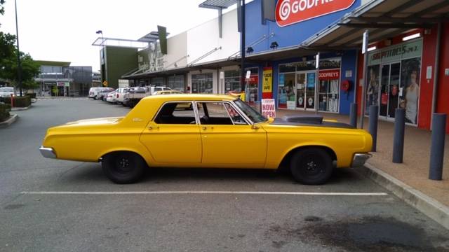

Hi All,
With the many posts about the 727TF’s shattering when driven the wrong way, I’m wondering whether it is at all possible to use or set up a 727TF for street sprints/track days at all?
While I’m trying to keep costs down should I be looking for something like aTH700 or later GM to go behind the LA?
The car is a 64’Dodge phoenix 408/727/3.9 9”
Thanks in advance!
Graeme.
