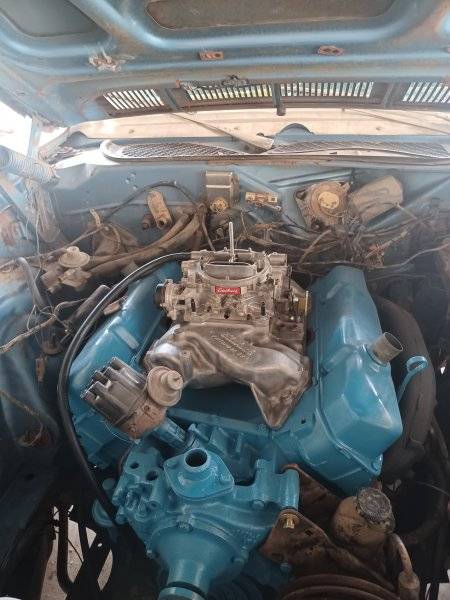

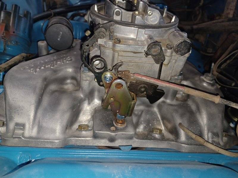

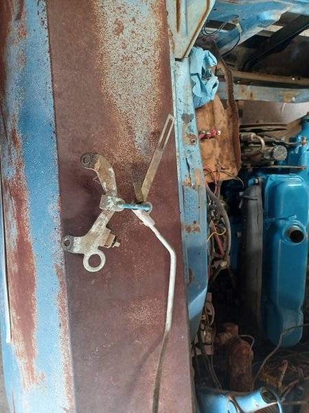

I am putting the 71 Satellite wagon together and need some information or advice as to how to rig in the kickdown linkage and bracket. With the Edelbrock intake the stock bracket does not mount (the intake runners are too high compared to the stock 2 barrel intake) and I haven't found a means of correcting this. I appreciate any help! Also by chance does anyone have a photo of the accessory bracket configuration? I seem to have lost my original shots...

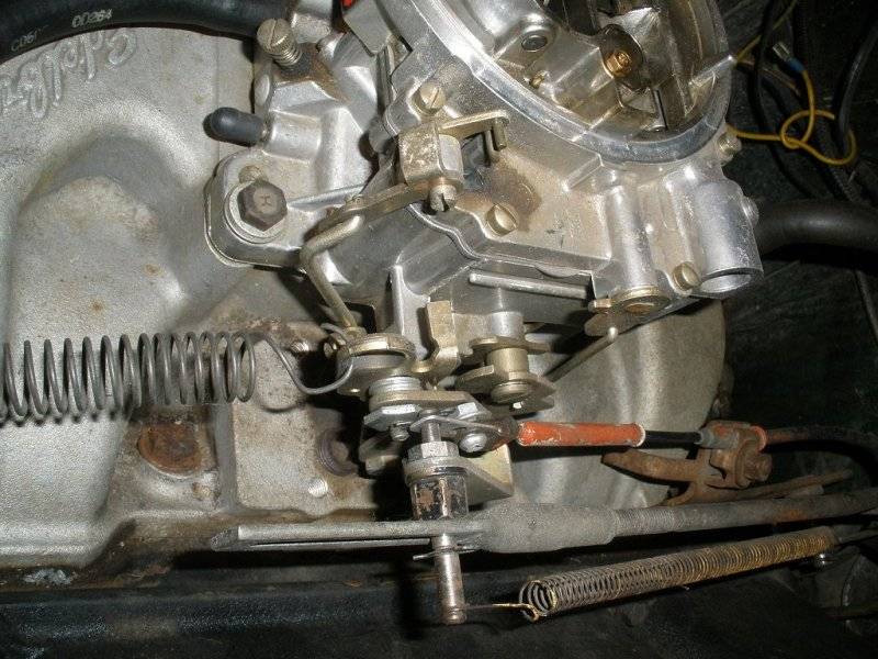

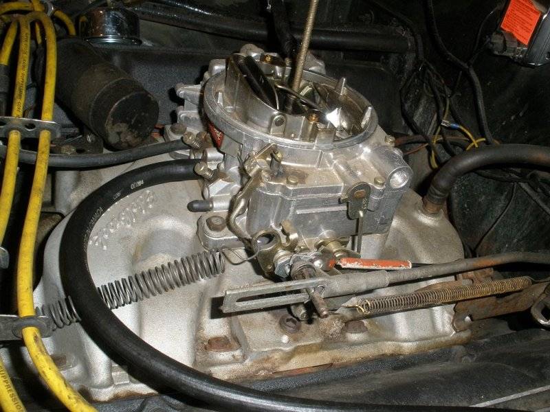

Here are some old pics I have of my carb linkage with an Edelbrock Performer 750 and matching manifold. I hope it helps. I'd have to take an updated close-up pic of the linkage because I did away with some of the Mickey-mouse workarounds like those washers and extension piece I added.
1971 Kickdown Linkage is a one piece rod - The adjustment is made on the throttle bracket itself with a bolt
I have not found a taller throttle bracket for the 1971 Kickdown Linkage rod , say if your using your factory 1971 Kickdown rod on a Edelbrock RPM Intake Manifold
However
383-440
With the taller or wider runners on say a Dual Plane Weiand or Edelbrock Performer intake , you might have to grind a v or a spot on the factory throttle bracket itself so it clears the intake runner and will align with the intake manifold bolts - No big deal
Looking at your 318 throttle bracket itself for a 2 Barrel, you might have to find the correct 4 Barrel Version off a 340 - 360 motor from 1971 - 1974 , I would assume you would like to use that one piece Kickdown rod , but that length would probably change also going with a 4 Barrel
