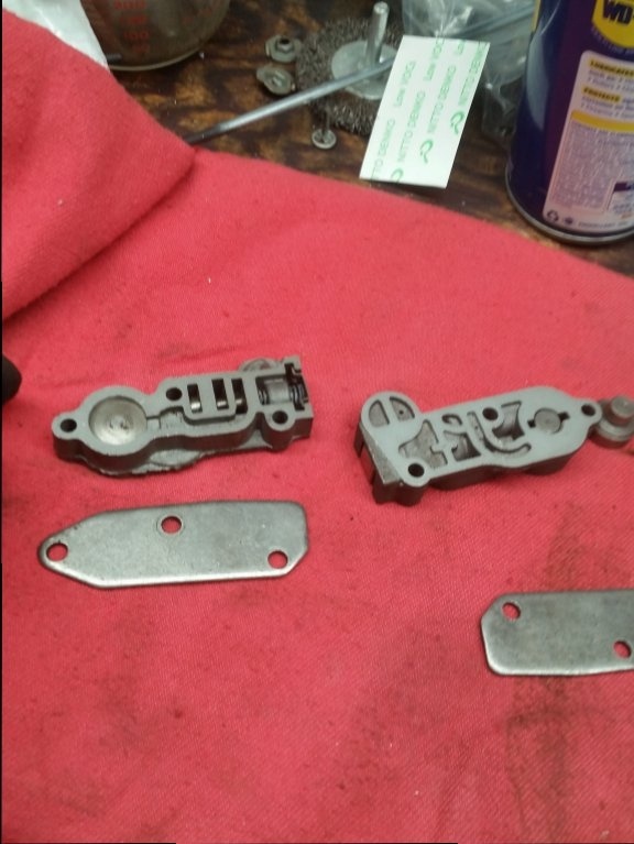

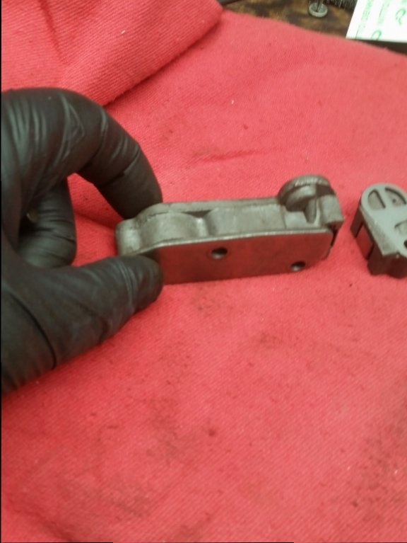

i cant remember the exact year that part throttle knockdown was introduced, but most of the latter Mopar trannys had them all the way into the early 90s.
you need this piece off the latter cars valve bodies to do it. and the valve body needs to be removed to add the valve to the main valve body.

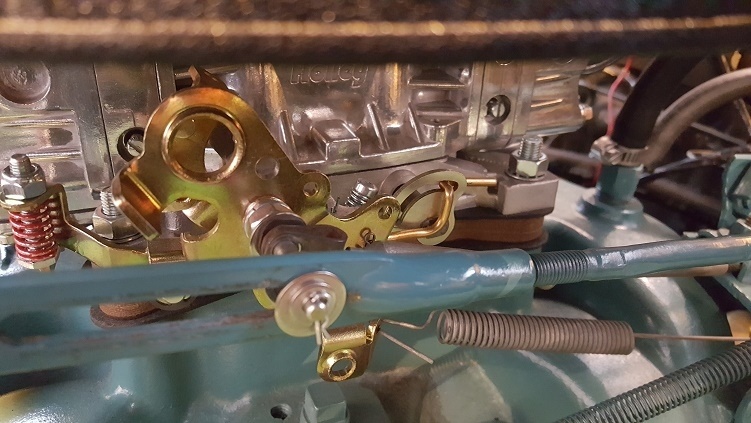

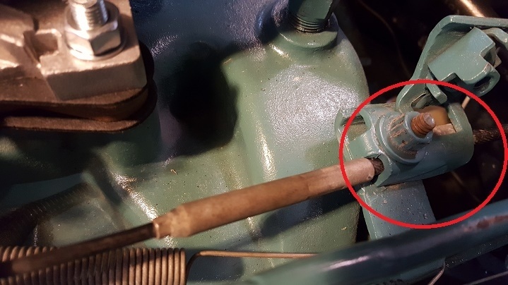

Here's my setup, not sure if that helps.

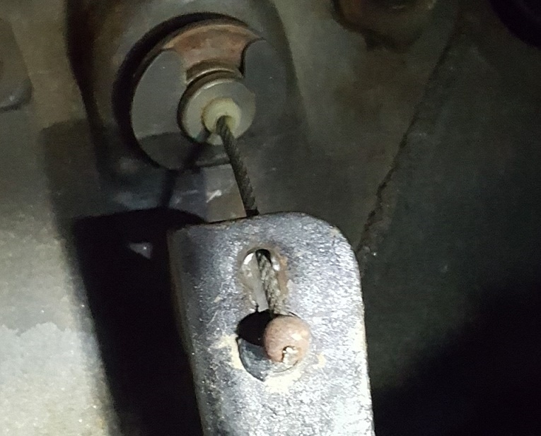

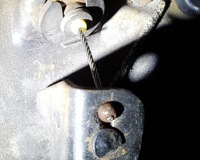

Upon further inspection, the throttle cable was loose at the pedal:
I loosened this bracket and pulled the cable towards the firewall and locked it back in place:
Cable is now snug but not too tight:
As to whether this will give me more throttle travel, it will have to wait until tomorrow when the weather clears up.

You need to adjust the kickdown lever. The way I do it is to loosen the nut(s) that hold the adjustment slider or cable in place. Then, push the kickdown lever towards the rear of the car as far as it will go. Then move the throttle to where you want it to be when the kickdown is all the way back, and lock it all down.
Don't rely on photos of other cars as the correct location will vary based on the carb, linkage, lever, etc. Just use the location of the rod end when the rod is all the way back as your guide.
