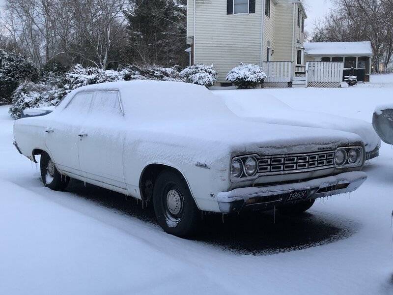

The 727 in my ‘68 Satellite 4 door locks up when shifted from 2nd to low. Anyone else have that happen? And know what causes it?
