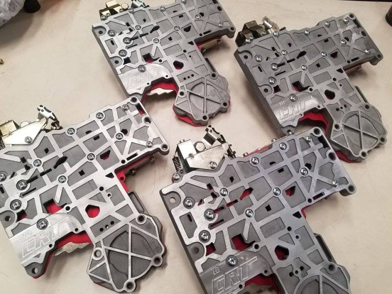

How do you tell a reverse pattern VB from a normal one when its outta the trans?
Cheers from John
Unless it has numbers to identify the only way I can think is to pull it apart and look at the manual shift valve. There might be a way to run a pressure test on certain ports if you know the flow pattern.
If those are what you have then call CRT. Then buy a different brand because he was making his own that would burn up a complete new trans he built in one race weekend. 11.00 A body light car.
”Oh I thought I fixed all of those” “I will send you some clutches and seals”. Never did.
