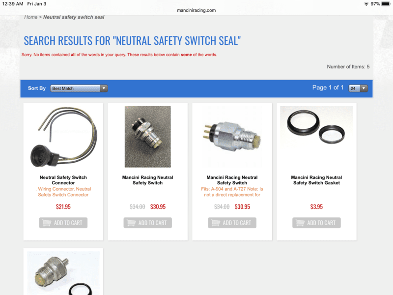

Did you get a seal with the switches? I had replace Neutral safety switch it is 70 coronet and the seal did not come with it. Are use the old one. Oops. I had to replace the neutral safety switch on a 70 coronet. At that time Mancini’s sold the seals separately.
I had replaced it with the old seal and I lucked out.The seal is metal with rubber or neoprene Adhered to it.
Thank you for advice and suggestions will go back across everything over weekend.
