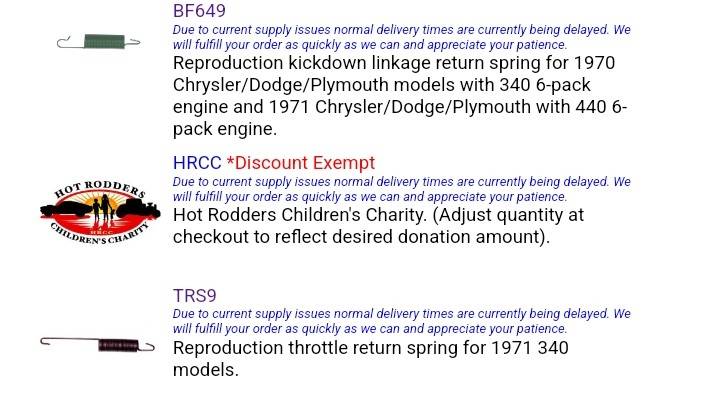

I have a Edelbrock carb and stock kickdown linkage..only kickdown linkage for a 727 340 I found was this on year one, also got a new throttle spring.

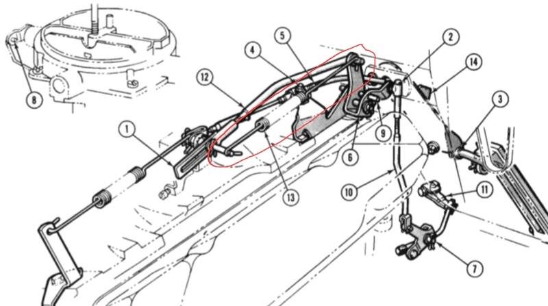

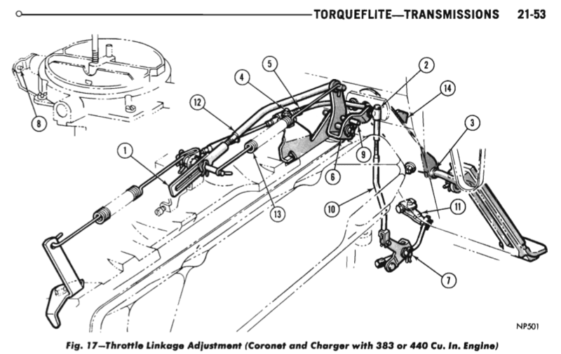

Thank you for all the advice. I got the manual and will be going through it....although, going back to my FSM, I believe the car came with the wrong kickdown linkage rod. Mine appears to be for a big block. That and the spring would explain a lot I believe.
Two pictures below. The first is the correct rod for a small block 4bbl. The second is the one my car has, the Big block rod.

If I recall the EDE carb has a different throttle shaft lever than the OEM carb would have. That may be part of the problem. I did a lot of playing around with my mismatched aftermarket carbs & the stock linkages. It can be done, but may take a lot of trial & error.
Yeah this car has a lot of random mismatched parts and short cuts from the previous owner. Luckily they do have the correct Edelbrock throttle shaft lever, part 1481. I think I'm just going to get a bouchillon cable, and call it a day given the hobbled together parts.
