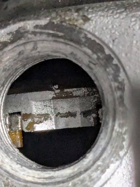

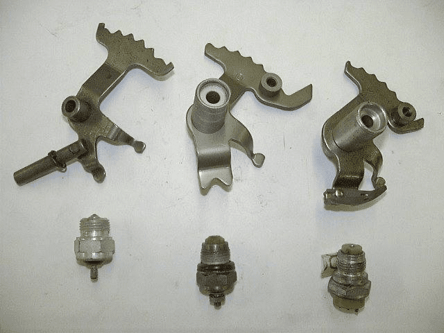

Put a scope in and I think it is indeed a rooster comb problem. Looks like I have the middle one in this picture:
If I’m understanding correctly, this would not work with a 3 prong NSS. I’m a little boggled about why it’s even in there.
Decided to cross check the serial and sure enough, 2801543 is a 67-68 code.
So now to figure out if I can just swap out the rooster comb over to the later style.

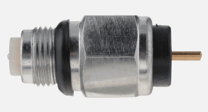

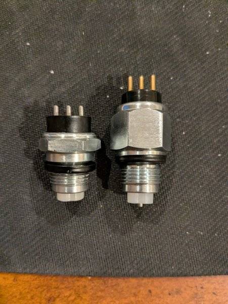

So I have a question. I see a different switch listed for 68 - 77. It is the longer body one below. The one on the right in the picture seems to be listed for 77 and up. Do they operate differently or is it just a difference in size?
I'm certainly no authority but, from my research over the last couple weeks, with 3 prong switches you have 69-77 and 78-97. The functionality is the same but the dimensions are different. Also noticed that the 78-97 switches are recessed around the prongs:

Yeah, the switch and insulated plug connector changed in '78. The switch works the same however.

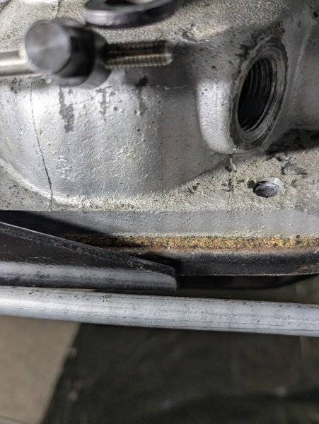

Hi there,
Definitely wish I had the answer. I assume the number should be on the casing in the picture.
Yes, it sure should be. It could be an early one. If the number(s) weren't filled in by painting over, then I'm guessing this transmission never had application numbers stamped to it.
My notes on transmission ID numbers suggests the early-early 1962-1964 727 Torqueflites (aka LoadFlite) did not have part numbers stamped on the left side pan rail. If yours is indeed a pre-1965 727, then it may have trouble working the backup switch, since backup lights weren't even a mandated thing (in the US) until 1968 or so.
