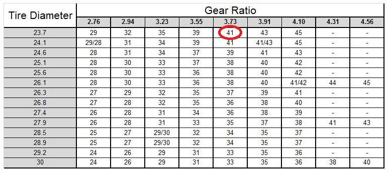

By the measurements you gave 3:55 gears with a 28 inch tire you need a 33 tooth gear.

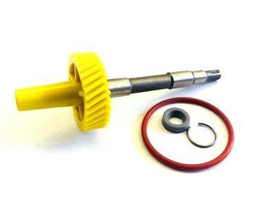

Here is one on ebay for 44.00 33 tooth gear.
Should be a yellow 33 tooth gear.
The measurements of the tires are a little different here but. 27.9 and 3:55 says 33 tooth as well. Disregard the red circle it was already on the picture.

Thanks, but the 62-65 727s use different speedo gears than 66 and up. Is there a chart like that for the older transmissions?

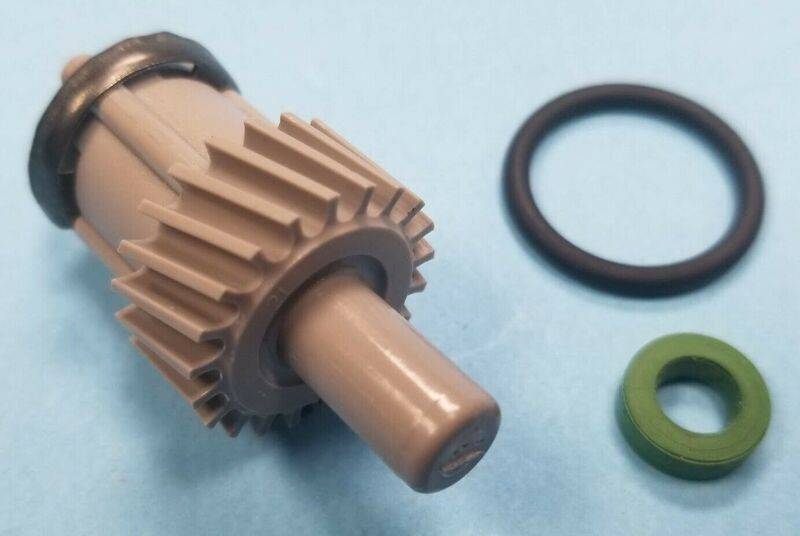

Here is an old gear. 62 to 65 the one pictured is a 21 tooth. And from Brewers Ebay page.

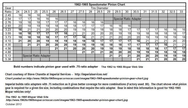

Here is the push button speedometer gear chart. This chart says you need a 20 tooth.. Which is HERE on brewers ebay store.
difference in the charts comes from different number of teeth on the transmission output shaft i think.
