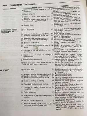

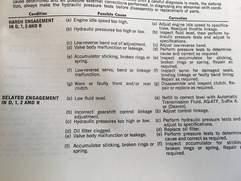

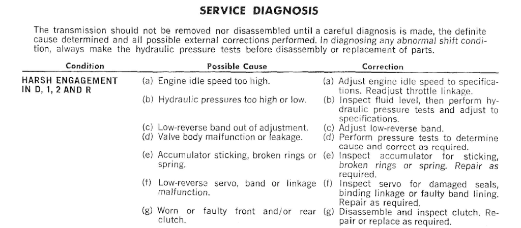

If you're saying that it bangs into gear, here's a diagnosis from the 1970 shop manual:
I was just going to post the same page from my 69 manual. :thumbsup:
Now some of the possible causes listed here in the FSA are pretty intimidating / catastrophic... remember just check the simple things first before assuming the trans has to be yanked lol.
