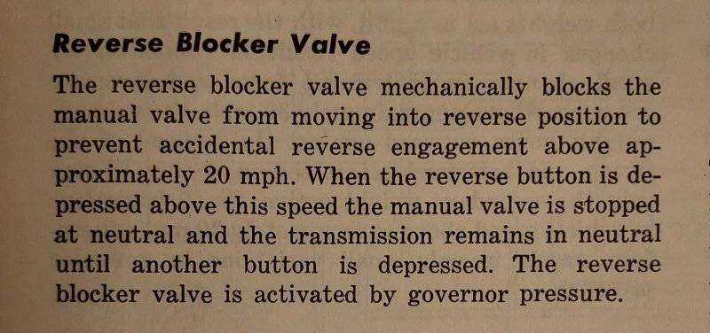

The early Torqueflight 8 (First year all aluminum) had a "Reverse blocker valve" which prevented reverse engagement at any speed over 20 mph. Don't know if this setup was continued in newer transmissions?
From the 1962 FSM...
Sure don't think so. Later model model with either column or floor shifter could hit reverse from neutral. Push button trans are different than the later models.
