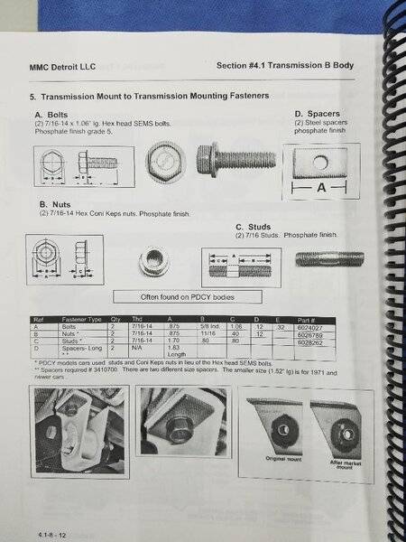

Is anyone reproducing the spacers for the transmission mount? Part “D” in the photo. I need a pair for a 1969 GTX.

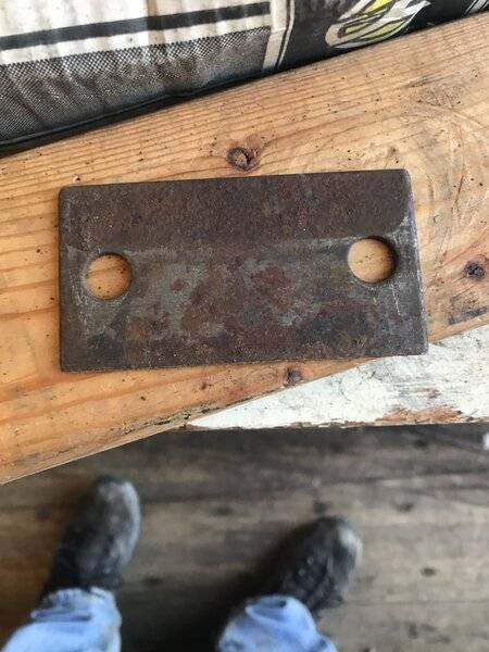

Did u notice that mount is for a 73 up car? The 69s didn’t have them. They used washers. They also have a flat plate between the mount and the tail housing. Kim
Thanks oldkimmer, I just used the picture for reference. I do have the correct style transmission mount. I believe the spacers go between the mount and tail shaft housing on my 1969 and the bolts use washers?
Thanks, I learned something new. My car is missing that piece that’s why I was confused. Guess I need to try and find that part!
