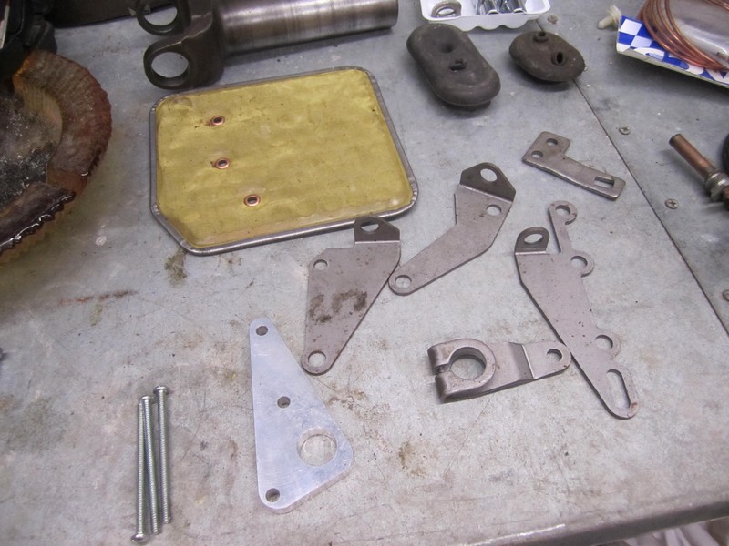

:blob1:I have these laying around if it could help.

I am not sure if it is the rod or the connecting plates that the transmission guy showed me as being nonadjustable and welded. I will have to stop in after work tonight.

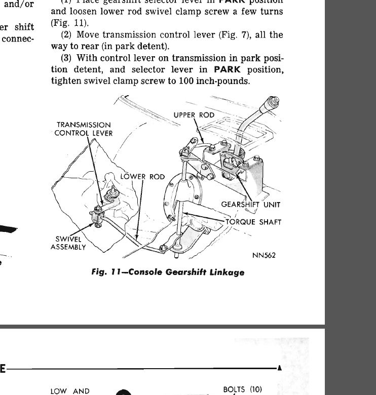

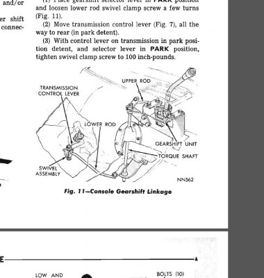

If park, reverse, neutral and drive are all falling in the correct spots 2 and 1 should also.

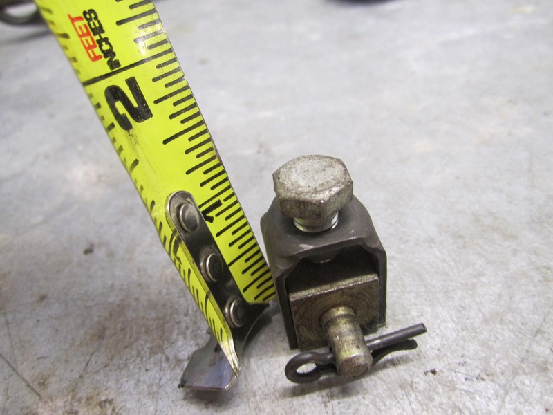

I was going to say- that "swivel" assembly is your adjustment.
