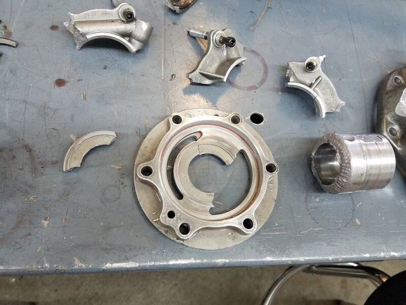

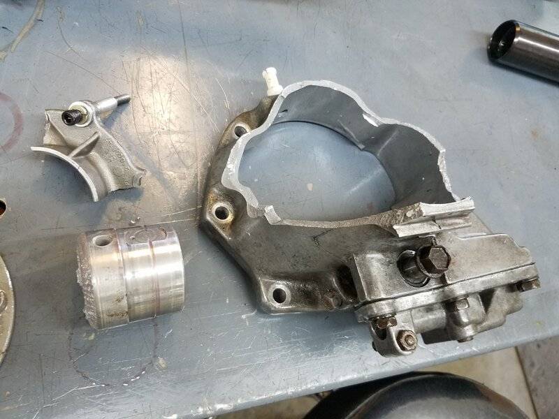

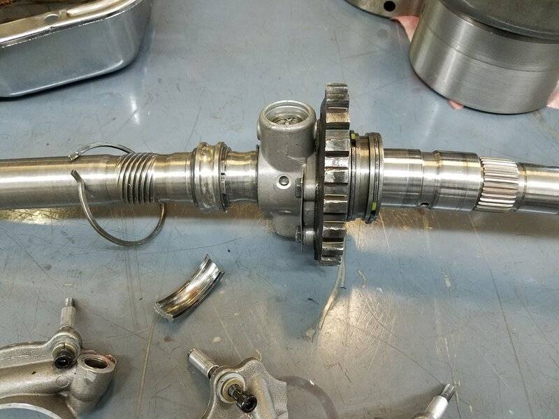

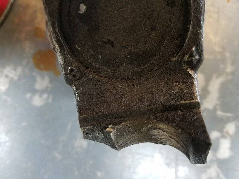

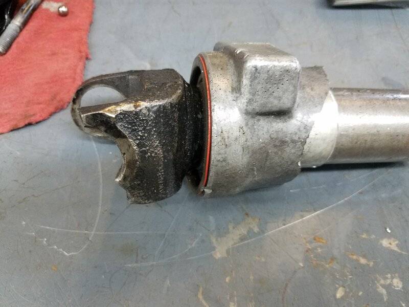

As promised the forensics after my buddys yoke broke on his 9 second 64 Dodge. This trans was on its maiden voyage. It didnt make it. Took out the drive shaft , floor tunnel , and broke the trans it had just gone into 3rd. This is a 65 push button so the parts appear a little different than a newer 727. It needs a governor support, rear pump cover, output bearing (yes it shattered the bearing), output shaft (yes its bent), and tail housing. Though the trans has some other issues they were not related to this failure.

This was not a fault of the trans. It was a driveshaft yoke failure. We currently run 2 push button 727s . One 850+hp with a trans brake, one 900+hp , foot brake. They live just fine. Most internals a basically stock.

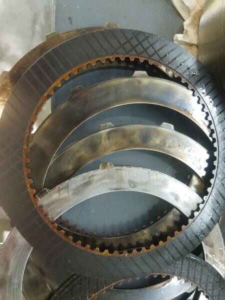

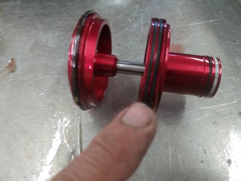

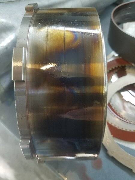

Only with aluminum drums. The additional failure on this trans looks to be an aftermarket KD servo. The piston seal leaked and cross fed the KD band and front clutch circuits. Did this affect the yoke by applying 2 gears at once? It's possible. Looks at the high clutch and drum. This trans was on its 1st pass. This was a brand new drum according to the owner.

Yikes! Was that a stock trans yoke?
The drum and steels look like they got hot.

Looks familiar... Saw a similar failure on a 440-6 Challenger back in the 90's... Like you said, not the trans fault...
