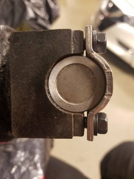

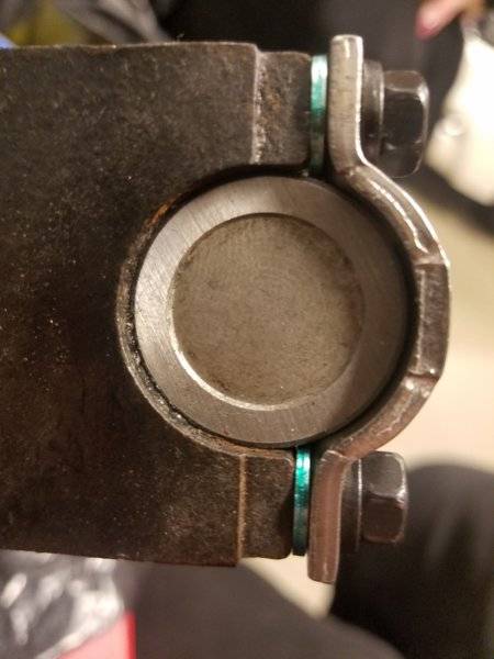

Chased the threads and they cleaned up great. Ended up using the smaller Moog 318-10 kit. Fit pretty well on the 7290 joint with a small gap between the strap and the yoke, added a washer to make full contact while remaining tight.

Those bolts are going to loosen up or bend where go into yoke and maybe break,IMO. $18 + shipping for the right ones at Mancini as lewtot said.
Didn't see washers but I wouldn't do that.
Last night didn't reread had to edit to add n't.
That would not work for me, get the correct straps.
Those look like 7260 straps
Pay the money, take the time to get the correct straps. Using those washers under the straps is asking for trouble. My thoughts.
Put everything together over the weekend. The strap makes contact on both sides when torqued to factory spec WITHOUT the washers. So I'll put a few miles on it then go back under there to inspect and check the torque and make sure everything looks okay. The car is about to go down for the winter anyway, I needed to get something together to get it on the road to get a few bugs worked out before it gets put away.
When you tighten them down like the stress IMO reduces their strength. The heads are being bent to the outside of strap, not good.
