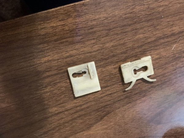

Studs across the roof with a hole at the curvature on each side. One stud below that and the clips are screwed on along the bottom of the sail panel.
Yes, plastic clips went over the studs and slid to the side to lock into place then the trim would press onto the plastic clips. It is one or both types of these clips.
Does anyone have recommendations on replacing the mounting studs on the roof? I have bought the screw in type before off of eBay but the heads were much too small to hold the clips.
The clips can be just held in with screws. They also make a stud gun that can attach them. On the ones pictured above there are two of the square ones below the louvers and the other style go over the roof.
