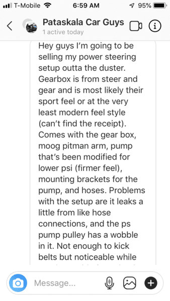

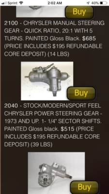

My good friend is selling his steer n gear set up with the power steering box, sport feel set up with the modified pump. Has the 1 1/4” sector shaft. Would this set up from a 73 duster fit my 67 Coronet? The Coronet is a factory small block car if that has any bearing and the dusters set up came off a smb too

Call Steer and Gear and ask them what the differences are to be sure.
The box and pitman arm will bolt right in and hook up to your linkage. If your car has power steering the steering shaft will also bolt up. If manual it won't. There were a few variations in pump brackets over the years and also different pumps etc. I am no expert in this area, so give it a try.
